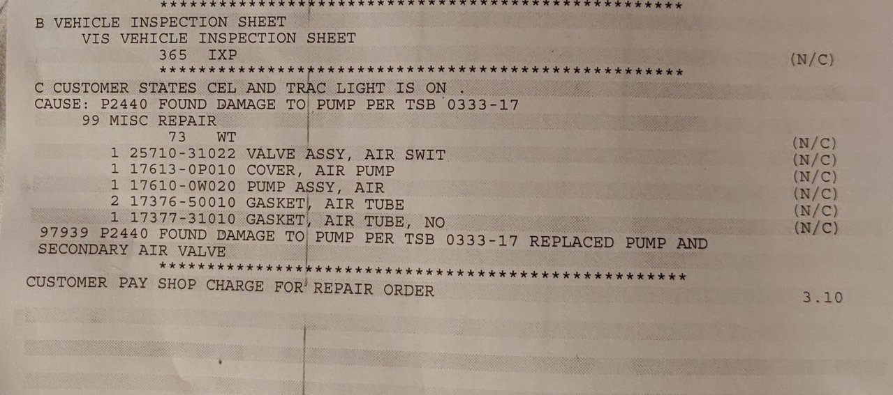

    A couple weeks ago I got the P2440 and P2442 codes. I checked this forum and several others and found that TSB 0333-17 (Technical Service Bulletin) covers the part. I had my secondary injector valves replaced at no cost to me!IMG_20181220_003625_2.jpg
    So if anyone is having a hard time at the dealer, just mention "TSB 0333-17", because it seemed like they didn't want me to know about it.

    She is repaired and ready to be picked up tonight at no charge to me. They did try to charge me a $150 diagnostic fee a but I spoke to the SM and told him there is no way I was paying it, that was waved as well.
    I said it once and I will say it again thanks, a lot this thread save me a lot of cash!
