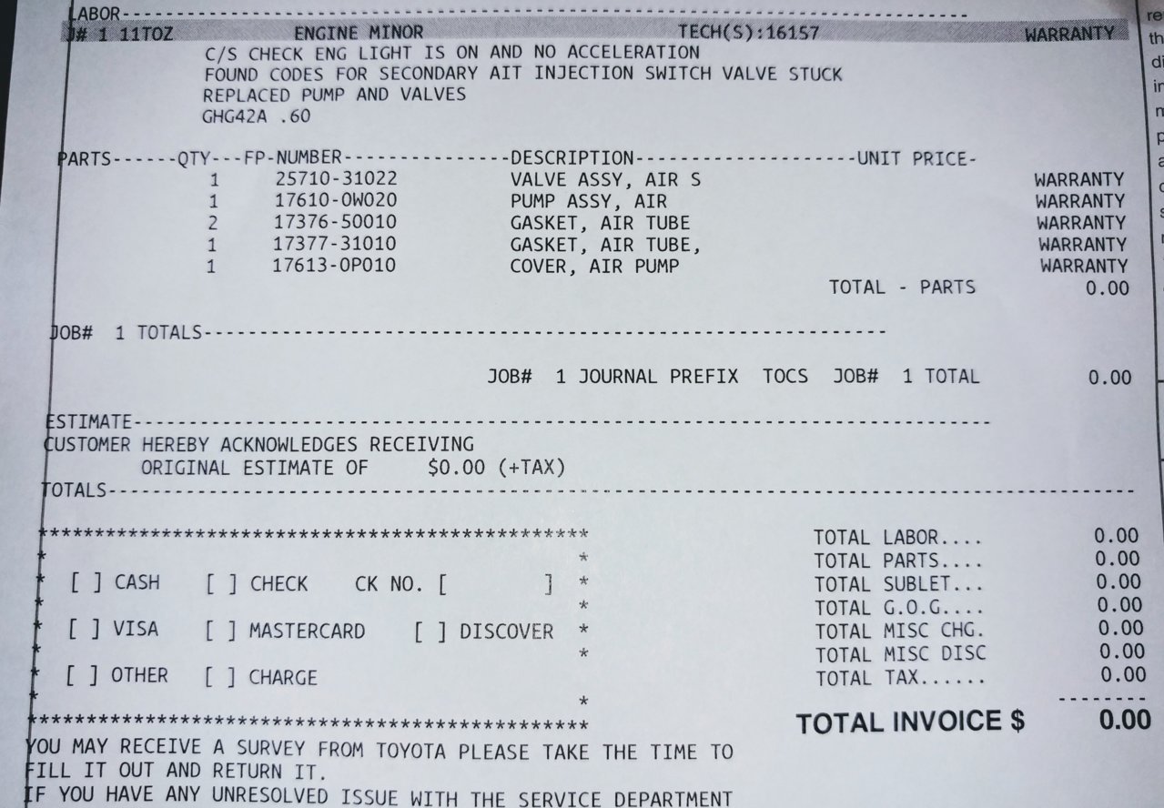

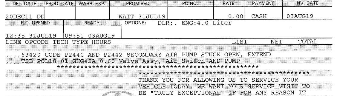

    Just a thanks to all who posted good information in this and other threads about the secondary air pump problems. About a week ago the check engine/trac off lights came on on my 2012 double cab with 63k miles. I checked the code - P2442. Reset it with my scanner, and didn't make it 1/2 mile before the lights came back on.
    I made an appointment with the dealership and limped in on a Wednesday. The air pump and the other parts involved were replaced under the extended warranty at no cost to me and I got the truck back on a Saturday. They gave me a free loaner (a 2019 Corolla, but I am not complaining).
    They had two sets of paperwork for me to sign - one had all of the prices on it and the other (that I received) had $0.00 for everything. I got a glance at the one with the prices and it was a $1,533 job.
    It was nice to go into the dealership with information, even though technically it should not have made a difference. I attached pics of the relevant portions of the receipt in case the information can help someone else.

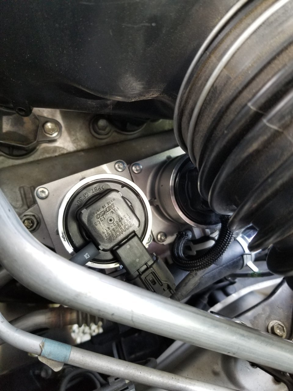

    2012 TRD Sport owner here. I'm somewhere around 104,000 miles and just had the P2442 code come up today, with the check engine and traction control light both on and limping, especially going up hill. I pulled everything out. The air pump looks to be in great condition and the filter under the cover is intact. Wiring is in good shape. Looking into the air injection valves I can see some rust, however I couldn't get the covers off as the torx screws were seized up even though they looked okay. Managed to get one of the eight screws loose, but stripped two. This was after letting penetrating oil soak in for a bit. I wasn't feeling up to drilling them out and then dealing with that. Maybe it wasn't the greatest idea, but I sprayed a bunch of pb blaster into the valves and let it sit for a while, then let it air dry for a while longer. Reinstalled everything, cleared the code, and all was well driving it around a bit. Of course, I'm just waiting for it to come back now...if it doesn't then great, but if so I'll buy the part and replace it (as I've already had it off, it isn't too difficult apart from working around some tight areas.) I'll look into this update for secondary coverage before I do that, maybe something good will come of it.
    During almost two years of owning the truck this is the first issue I've had, though it's pretty frustrating! I'm used to replacing parts on my '97 Cherokee, this was my first time under the hood in the Tacoma for anything other than an oil change. Bad timing too, as I'm really close to needing new tires! I'm not looking forward to potentially spending another $500-ish on top of that haha

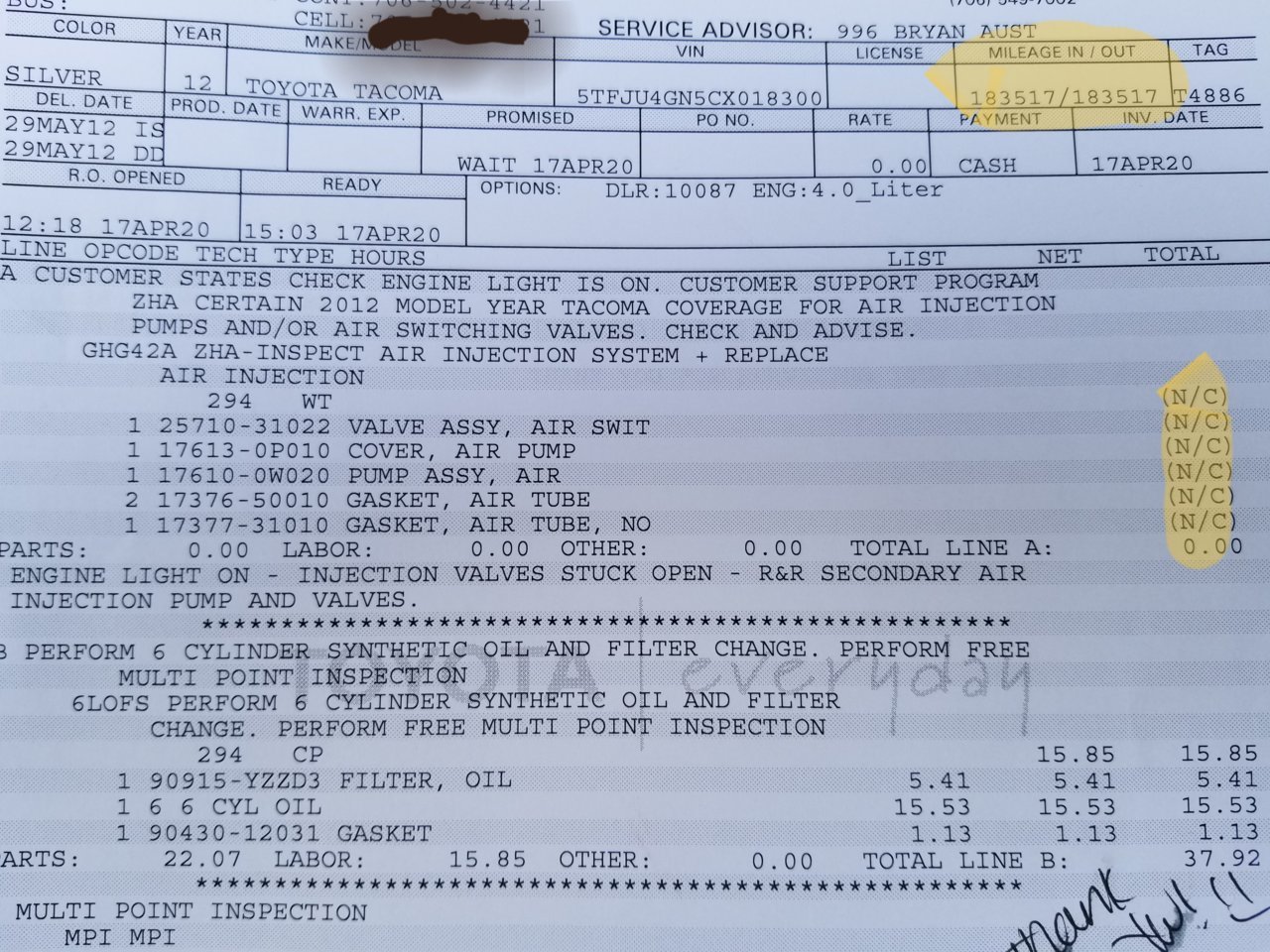

    My 2012 Tacoma with 183k miles went into limp mode yesterday and had the infamous P2440 & P2442 codes.
    After reading about TSB 0333-17 here on Tacoma World I too followed everyone's advise and reached out to Toyota USA Customer Care (888 270 9371) this morning.
    I was pleasantly advised by customer care that indeed the warranty was extended up to 10 years from the original date of purchase and unlimited miles.
    So now I'm sitting at the Toyota Service department for them to confirm the codes and warranty coverage.
    After I inquired about them providing me with a loaner vehicle while my truck is waiting on the parts, they have agreed to do so if they find it is the Secondary Air Injection Check Valve and Pump.
    I will update my post when all is resolved, hopefully with a positive experience.
    Update: 3 hours later, my truck was ready to go. No charge for parts and labor. I was ready for an oil change so I had that done while there. $41 out the door.
    Thank you all for all the information you provide on this forum.
