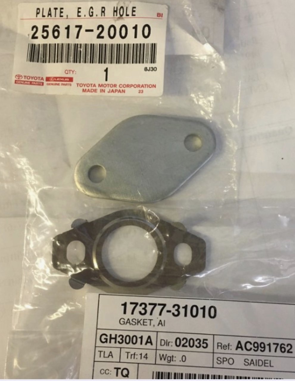

    Anyone have a part number for a block off plate?

    Almost a perfect fit. Just a little file/dremel work to enlarge the stud holes and it'll do just what you need.

    The only way to get rid of the dummy lights is to get the above block plate kit and use tune software for a fee?
