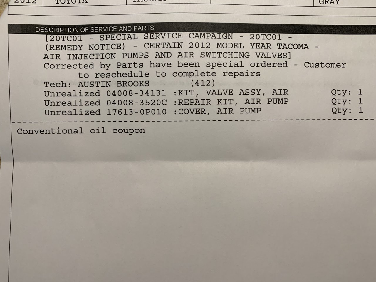

    I take mine in 9/24, after an inspection last week.. They had to order parts, and service writer specifically said the pumps were back-ordered, just got in today. I hope this means they ARE going to just replace all and not just try to fix the pump that's been on the road for 9 years. Don't know how they'd verify the pump was ok w/o taking it apart anyway. But they keep the option ("as required') in the notice. So far no codes though.

    Took it in today and they just did the pump repair/cover and well as the valves......hope that's it. I wanted a new pump but too much to ask for. I don't run it off road or in dust or too much towing... so hope it's ok. Got about a year and a half left (Jan '22) of warranty for it to show a problem.....

    #716
    jsriolo
    jsriolo Well-Known Member
    Aug 30, 2015
    #163008
    76
    Susquehanna, PA
    2015 TRD Off-Road V6 6-Speed 4x4 Access Cab
