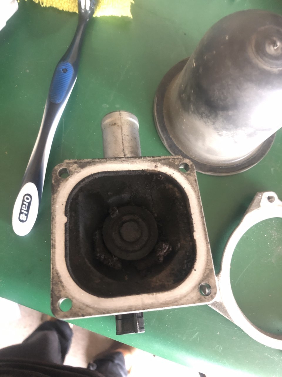

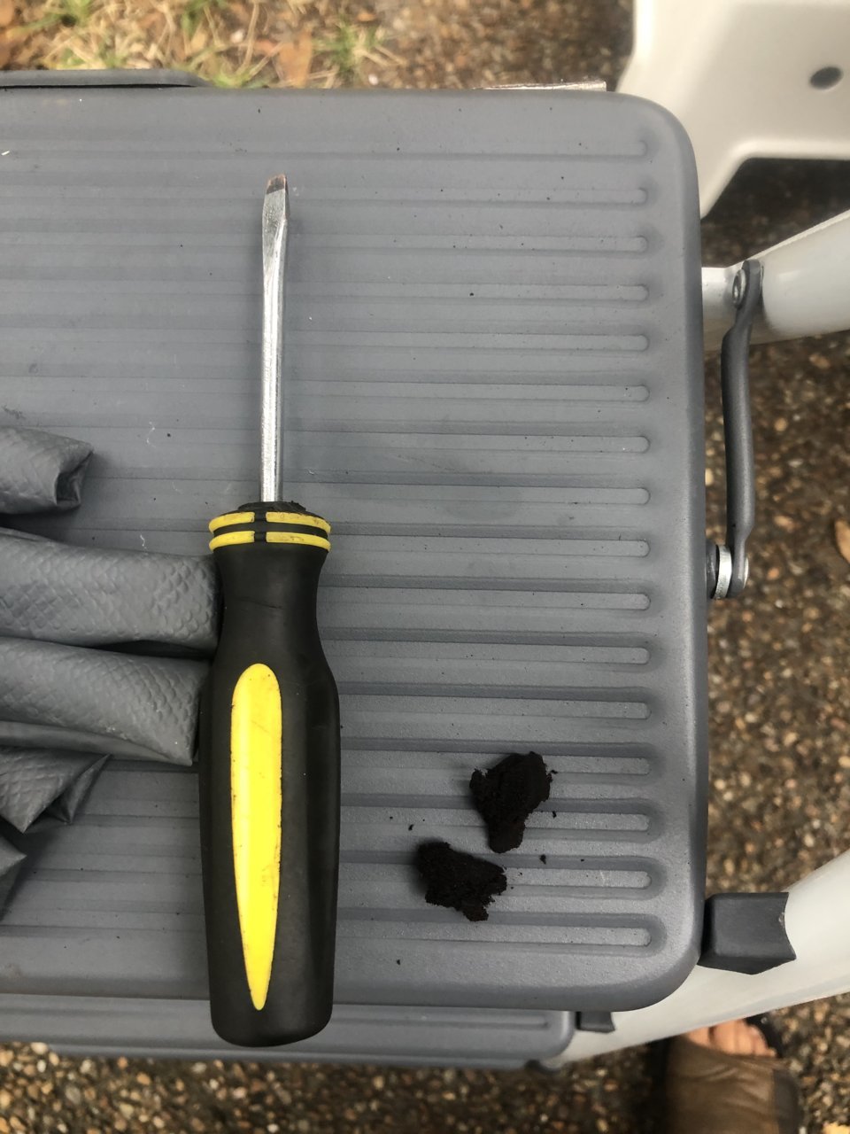

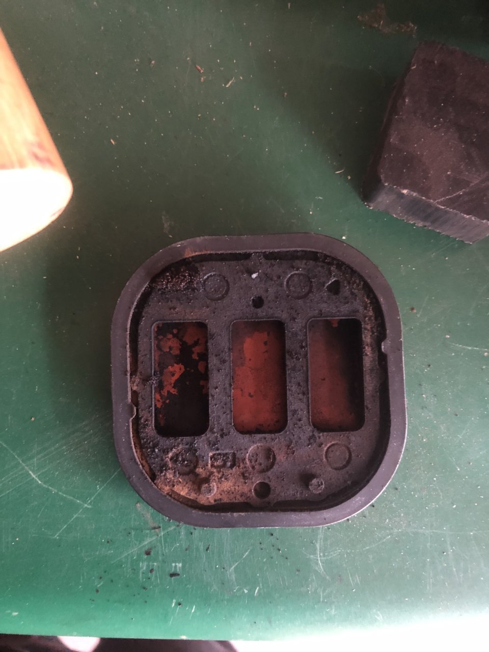

    I had p2440. Turns out I had sponge stuck in the valve that kept the valve from shutting. I guess.
    I removed the sponge pieces from both the top of the valve and the bottom.
    does anyone know if the studs that screw into the engine are reverse threaded? I couldn’t get them out. Any tips on how to get those out would be greatly appreciated.
    Since I couldn’t get the studs out, I just took the 4 t25 torx screws out and took the top of the valve assembly out. Save me some time BUT if I eventually need to replace that valve, I’m gonna have to figure out how to remove those studs.
    ALSO, I have the 2.7 4 cylinder AND it’s a 2011

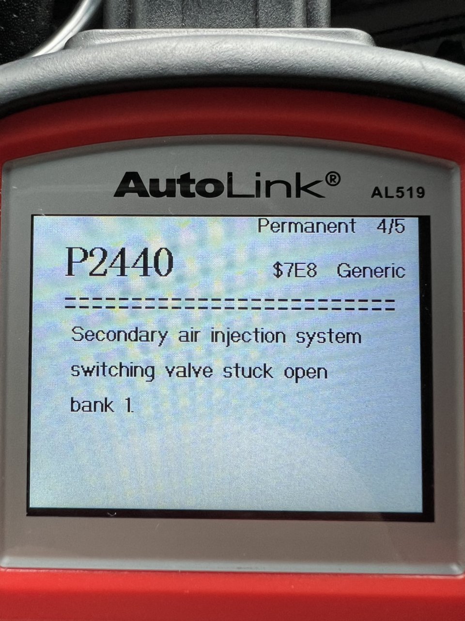

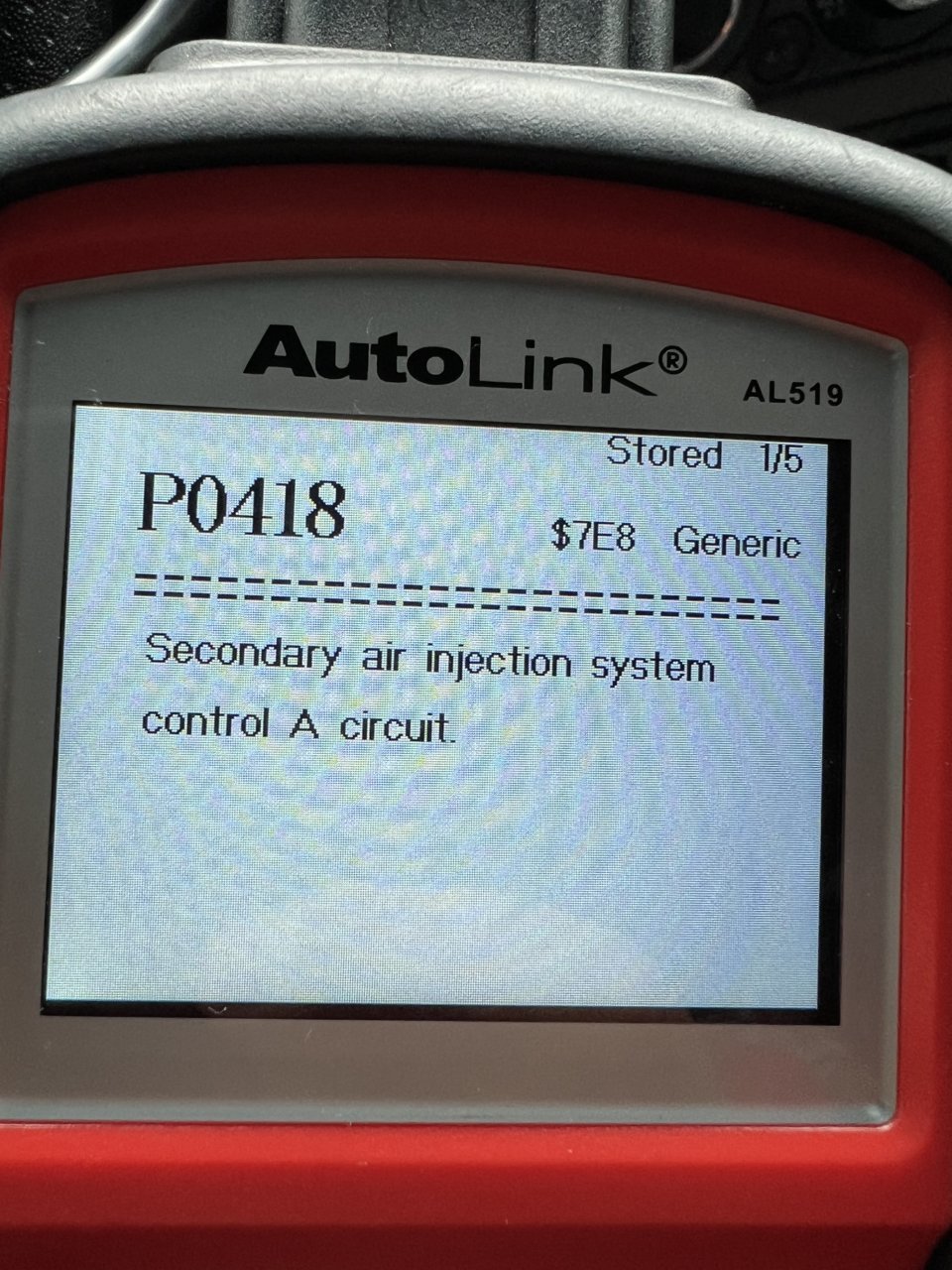

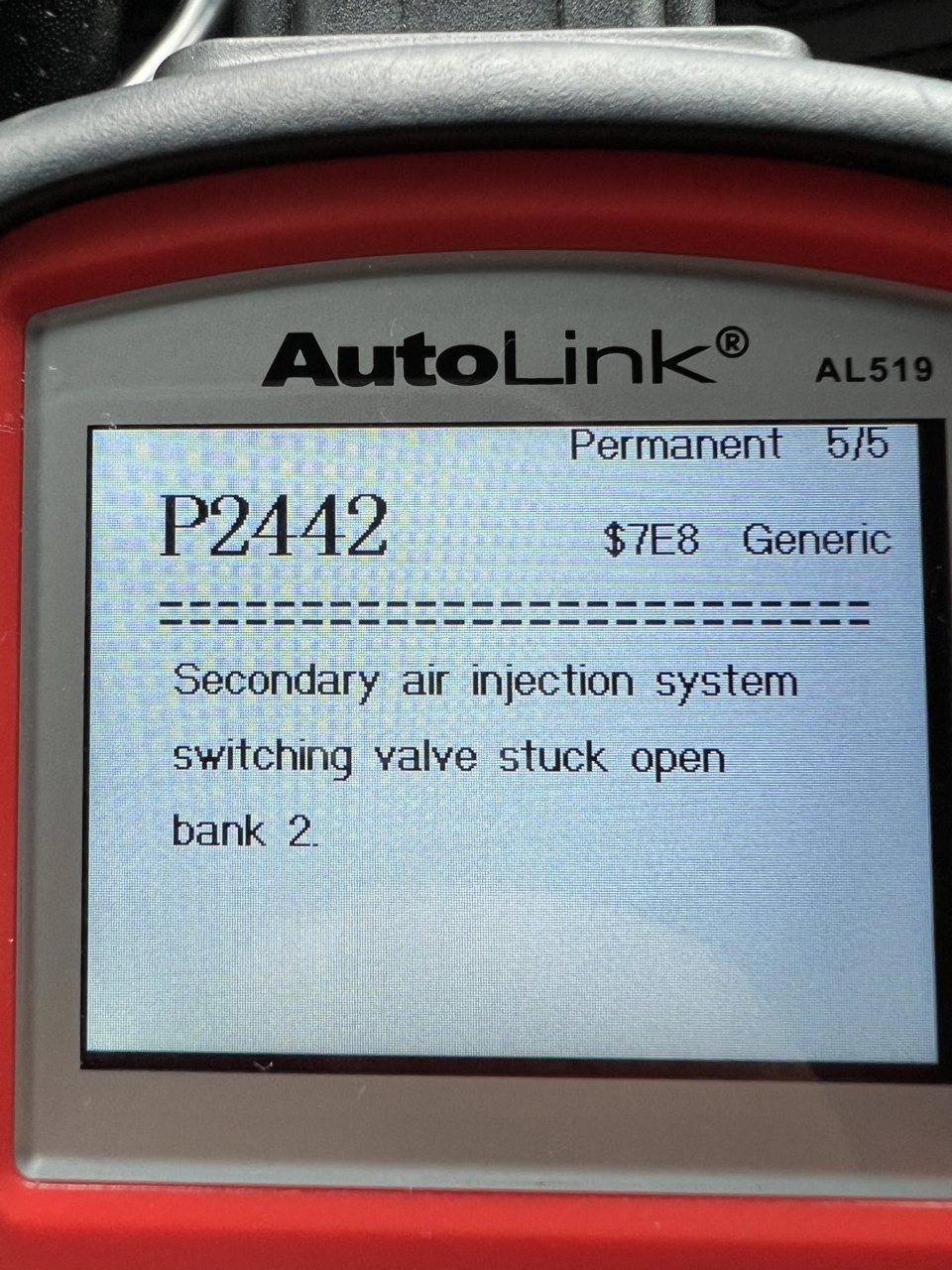

    Will the GEN2 kit take care of all this, think I might have to give in. I’ll clear the codes, drive and in the middle of the drive I can feel a slight hesitation and won’t accelerate past 40-50km. After a 30secs, it goes back to normal.

    @TegoTaco As long as you do not have any damage to the Pressure Sensors the Gen 2 Bypass Kit should be all you need. That said, our Bypass Kit are engineered to work with Factory/OEM equipment and seen a lot of issues with aftermarket parts because they are cheap for a reason. So if you had damage to the Pressure Sensor or had aftermarket parts installed there may be a need for our Pressure Sensor addon in addition to the bypass kit. However, you can always install the Gen 2 Bypass Kit first and get the addons in the future if needed. Please let us know if you have any additional questions.
