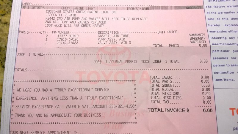

  19. Jan 10, 2017 at 10:55 AM
    #159
    TRD-ED
    TRD-ED Well-Known Member
    Sep 12, 2016
    #197086
    3,315
    Lenoir NC.
    2020 Army Green TRD PRO - 2023 Genesis GV70
    Stock FOX 275/65/18 At3w 18X9 Fuel Vapor's
    Got my valves and Air pump replaced yesterday. Thank goodness the parts finally came in. I was getting tired of unhooking the battery every morning to clear the Limp mode out. And my many thanks to my local Toyota dealership for getting this $1800 repair done under a "Goodwill" warranty. I still don't understand why this is not covered under the emission's warranty. Being it is 100% emissions related.

    Nice. We may be the lucky ones. Maybe its a NC thing!?!
