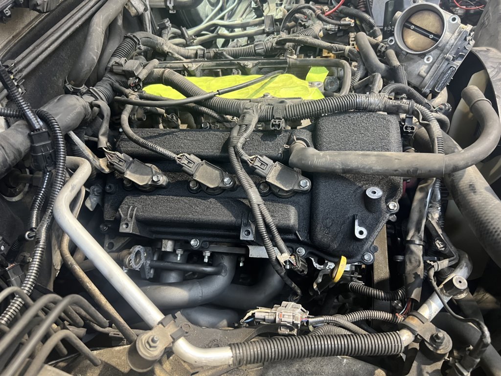

    For what reason? Once the headers are covered, there's nothing else to cover up? Unless you are just trying to get rid of these studs?

    Just had my whole SAIS unit removed, didn’t need to a pre ‘12 valve cover.
    Could he had meant the gaskets for the headers??
    Slashaar likes this.

    Shit bolted onto other shit, and junk.
    yes, gasket. Not the valve cover.

    IMG_9315.jpg It’s been over 5 years. I thought I read it on TW somewhere they had to be swapped. I went all the way into the cam gears and to the Y pipe. When I came back out I cleaned everything up.
