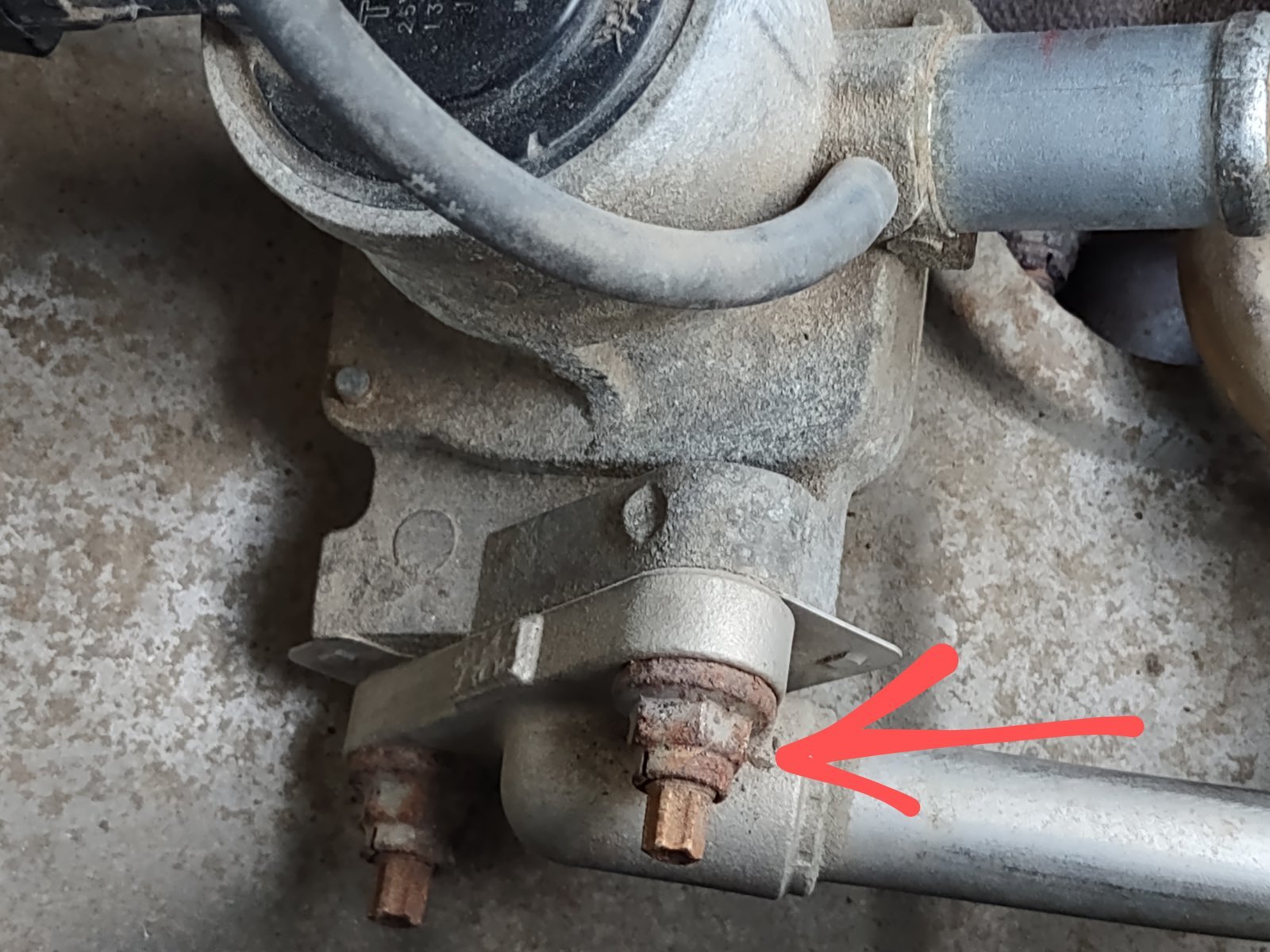

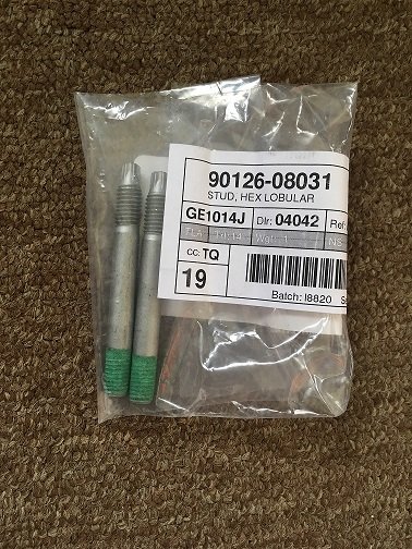

    When I first got the code, I figured I was going to have to replace the secondary air valve, so ordered a new valve 25710-75015 and studs 90126-08031 and gasket for the connection to the pipe to the exhaust 25717-75010.
    When my order arrived, there was only one stud in the package, while posts 1 and 17 indicated that you get two.
    I emailed the Toyota dealer about it, referencing this thread, and got the following reply:
    "Online posts aren't always correct. Toyota sells everything individually. No sets of bolts or clips or nuts. All individual which is why you only received one."
    I'm going to have to pick up another at my local dealer, so I'll see what he says.
    But if you are buying online like I did, I suggest you confirm with the seller that you need two studs.

    In the meanwhile I did pick up a second stud 90126-08031 at my local Toyota dealer, and he also said you get just one stud.
    So you would need to specify two of 90126-08031.

    Stud Hex Lobular 90126-08031 (Old short mount studs replacement, 2 needed)
