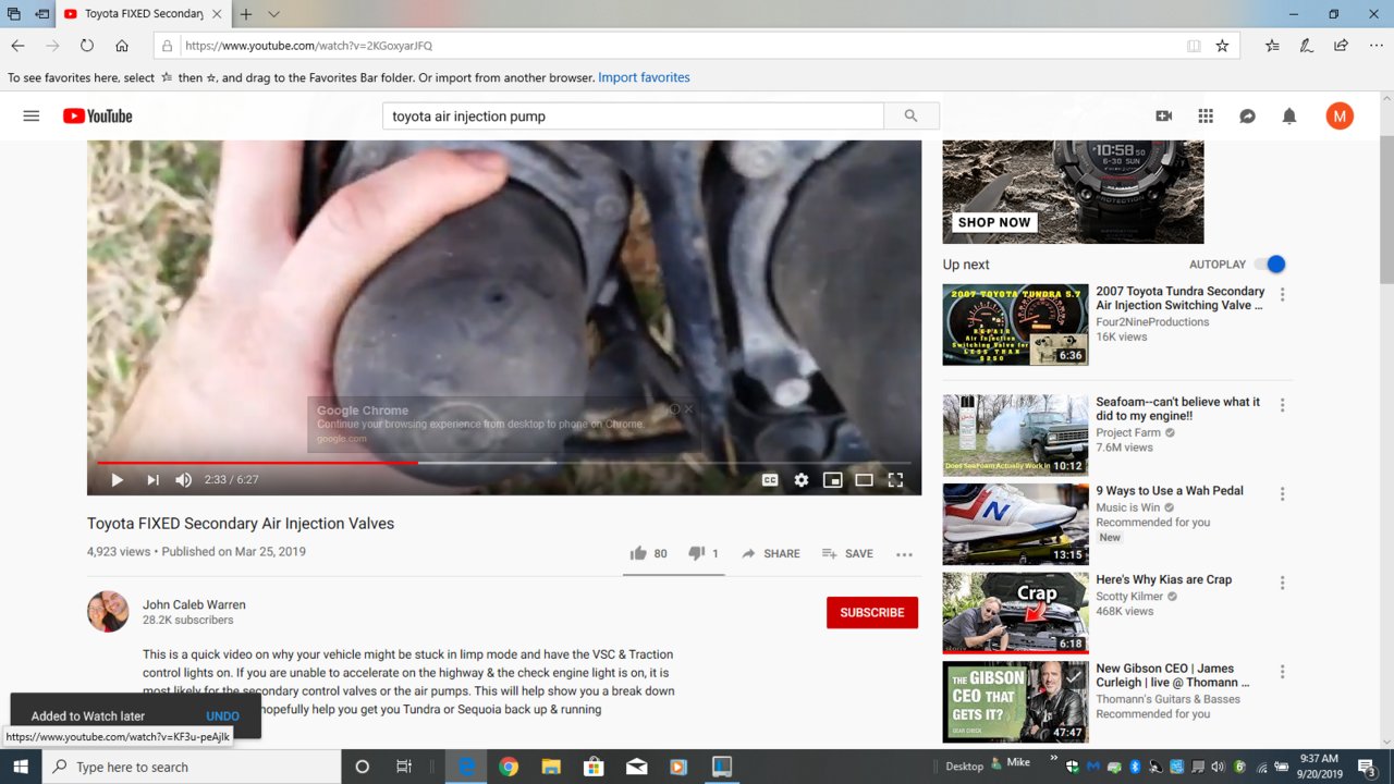

    Cool. I just found this thread (OLD) that talks about water in the pump.
    https://www.cargurus.com/Cars/Discussion-t42450_ds655624

    The video in post #1 focuses on a Tundra 5.7L V8. Pic below of the 2 sections(made of rubber) that he pokes a hole in for water to drain out of . Further down is a partsouq.com URL pointer to an air injection diagram for this 5.7 - taken from a 2017 model. The 2 rubber tubs are easy to spot.
    Just past that URL is one for a 2015 4.0L V6 Tacoma. Looks similar - just has 1 rubber tub(my language)
    5.7L V8
    https://partsouq.com/en/catalog/gen...vg$&vid=0&cid=&uid=363074&q=5TFHY5F15HX659333
    4.0L V6
    https://partsouq.com/en/catalog/gen...ao$&vid=0&cid=&uid=285062&q=5TFJU4GN1FX066364
