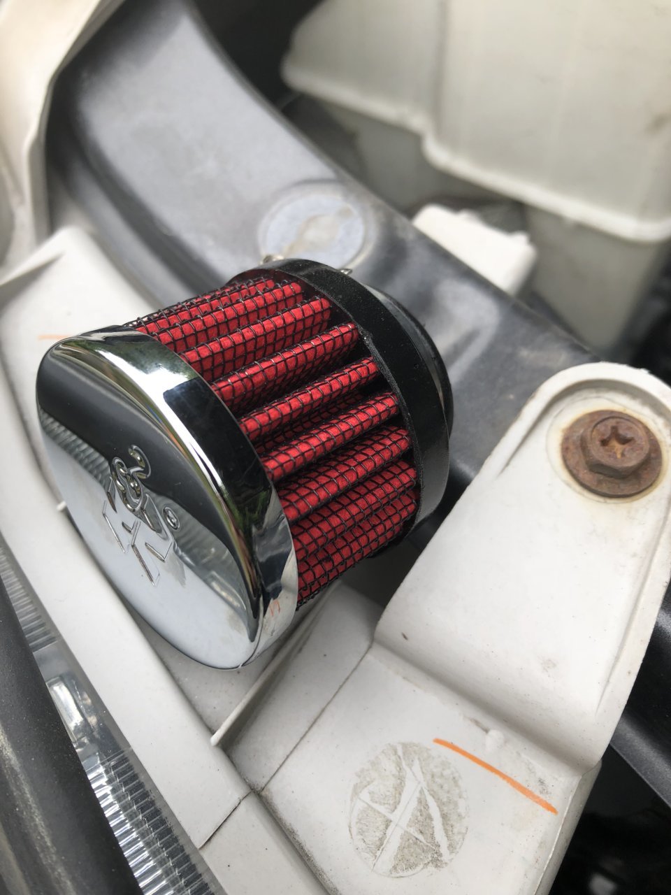

    its 2012 v6's only that have the warranty extension. This is the only year / configuration where the pump wasnt programmed to do the shutdown purge.
    I put the uni filter on mine years ago and have not had an issue.

    I have the K&N filter, and no need for it. $30 PayPal gets it shipped to your house.
