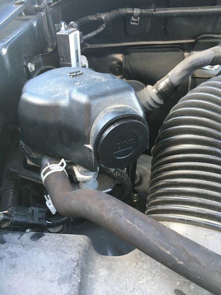

    Done. Has cover.

    Looks good.

    Only thing clean under the hood. :anonymous:
    On another note, the removed foam was pretty dirty/dusty on one side. Never gave it a thought until I saw this thread.

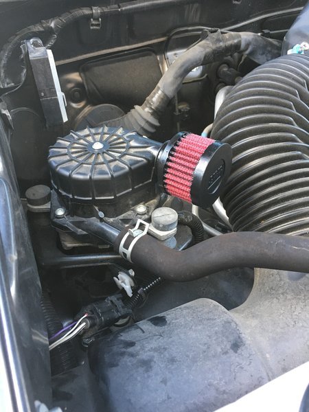

    image.jpg My filter just Arrived. Thanks @nd4spdbh For the Hook up! The filter looks to be well made.

    Foam deteriorates overtime and specially in heat so I don't know why Toyota even used it in the first place.

    Uni has always made great stuff.

    thanks for posting these. Now I know mine will work with the cover on.
    I thought that it might not work since I relocated the smog pump a few months ago - but the pictures prove that the filter will remain under the cover and not be exposed.

    Got mine done today should I keep it without the cover or put it on?

    Looks much better with the cover.
