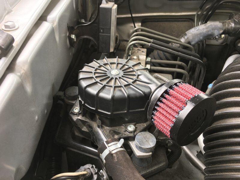

    IMG_6419.jpg Finally got mine installed it only took three weeks to arrive. 2013 50,000 foam looked completely fine thankfully, glad to have this taken care of. Thank you op and everyone that aided in this thread.

    Installed the Uni Filter on mine today - 2015 DCSB TRD Off Road 4.0 4x4 - the pump cover has two attachment points. The inner one proved a bit difficult to manipulate, and the plastic cap yielded to gentle prying with a small screwdriver while "rocking" it off. At 28,600 miles, filter looked good. Uni filter installed under the cover with no issues. Hopefully this helps dodge a bullet on down the road somewhere. All thanks to OP for the very useful tip, I had no idea the truck had this wonderful bit of technology on it.............air filter.jpg taco.jpg
