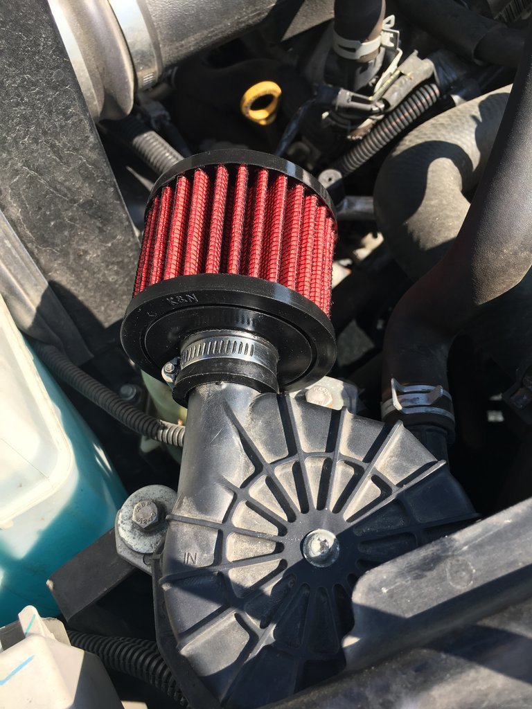

    In the front, where the round end of the Uni-filter is poking out from under the cover.

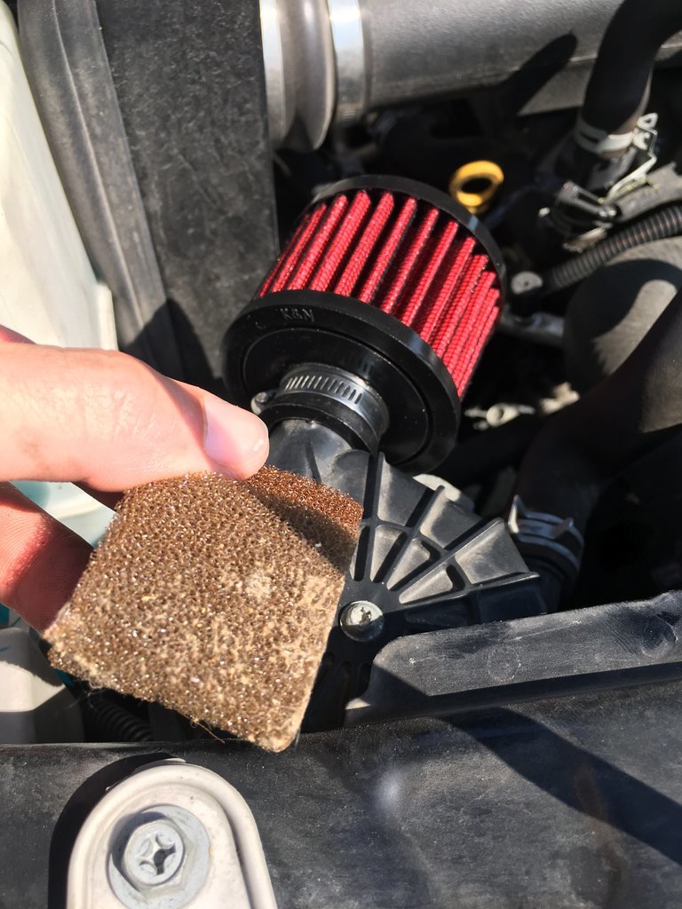

    ordered the K&N one to match my intake, anyone had any problems with that one?
    Also seems that separating this sounds rather difficult from what I've read.
    other than what I've read, any other tips or tricks??
    Edit: I'm at about 155K give or take on MY 12 Tacoma sport. Thankfully I haven't had any issues but since I've read this I've been worried.

    That should work just fine. only reason people bought the "uni" brand one is on 2013+ the air pump had a plastic cover that the 2" diameter uni filter fits under to look OEM. It was my impression 2012s don't have the beauty cover so the 3" diam KN won't matter for you.

    dude thanks so much, this was my thought. A filter is a filter but just wanted to make sure.

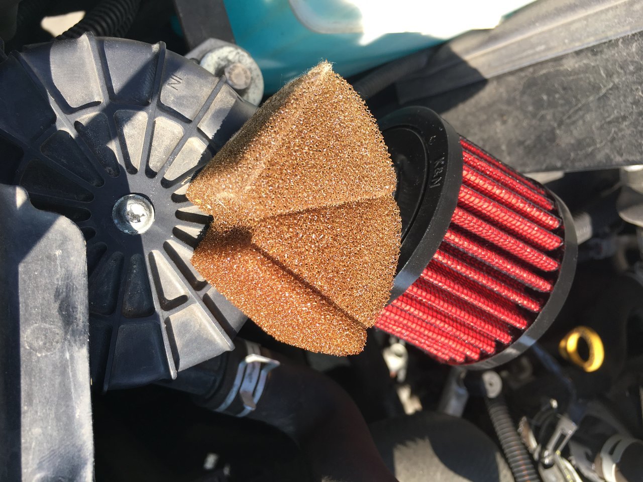

    Installed no problem, I had to relocate my air pump when I installed my K&N short ram intake so that no one is confused, I had no problem plenty of space also because I'm 2012. I don't have that top part. I'm a little over 156K when I changed this out, mine looked pretty good there was a little bit of dust and a few small bugs inside the air filter that this new one will prevent from happening.
