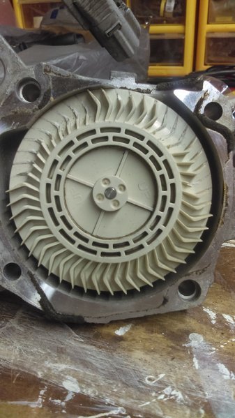

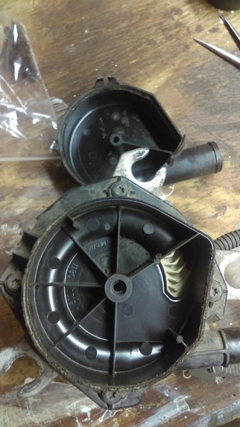

    I went ahead and decided to just man handle it open. One of the plastic lips cracked. I found that the impeller has blades on both sides, and the back side (which I cannot get to because the shaft is pressed in through it into the motor housing, which I do not think can be removed). Luckily the top side only has the damage. Clearly the foam filter deteriorated and got sucked down into it, entirely (there was no foam left in the pump), no evidence of a retaining device for the foam filter in the design.
    I think I may attempt to cut off an equal (ish) amount of fins, by dividing the impeller into sections. The reason I say equal-ish is because the impeller has 47 blades on each side... Inconvenient, but I think that be able to even out the weight distribution enough so the impeller wont be significantly unbalanced. Hopefully with a little more even weight distribution it will not cause it to tilt and hit the casing. The way it is I would be very skeptical about the impeller tilting and hitting the casing (causing a lot of the blades to break or possibly it to all break into pieces).
    Opinions on attempting to do ^^?

    An entire bypass is not the perfect end all solution, or really anything I see my self entertaining. People are having issues with those bypass things, and no small ones at that... Limp mode and codes thrown, tows to shop. All to find out they have to pay for the new pump anyway, now they are out $ for pump + tow + labor + the bypass. That is not even getting into state laws on emissions and without it I would bet money you would not pass an emissions test... That is why toyota put them there to begin with. If you even think you may move, not the right way to go. Then selling it with that done, probably a legal thing that could come back to haunt you... 'man sues seller for illegally modifying vehicle emissions system', lets be honest, people sue for much less significant things and get a lot of money. Suing over this would actually make since.
    @Scrubber3 I would suggest doing something, if you leave it be you are very likely to end up in the same situation. I wish someone had taken the time to put up what I have, would have saved me a lot of BS. I would role the dice with no filter, but that is just me. Maybe mount something on the outside. The intake opening attachment (the round thing on the intake tube) can be taken off, maybe clamp some sort of filter on that.

    Lets get one thing straight @TXpro4X4 this pump in no way shape or form benefits YOU as an end user nor will it give you 5 or 10 extra ponies for having one in place. The function of this pump is to inject additional air into the exhaust mixture downstream of the exhaust into the catalytic converter in order to allow the truck to have cleaner emissions at the tailpipe. Up to 50% cleaner emissions actually. This tells me that without these, this 1GR 4.0 motor runs very dirty from the factory. Rather than finding alternative solutions which can be integrated by making small revisions to the way the VVT-I works, etc. etc. Toyota chooses to be lazy and half ass "revise" these engines into having this otherwise shitty built part and than charge boatloads of money so they can make more money from you off a part which they already know is built like shit later on down the road. The sort of tactics GM implements into their vehicles actually.
    Now, as a solution, pull the foam filter out entirely. Exhaust fumes are exactly that. Just fumes. There are no additional contaminants that could otherwise damage that fan. Thinking about this thread I should probably go out and do this myself. I'll have to check it soon.

    On the topic of taking the filter out and fumes or what ever:
    This pump sucks air in, and pushes it into your exhaust system. I do not see how any sort of fume lingering in your engine bay could matter when it is just getting put into your exhaust system. It does this through a pump designed to move air and a check valve. The only possible concern I could see is particulate debris.
