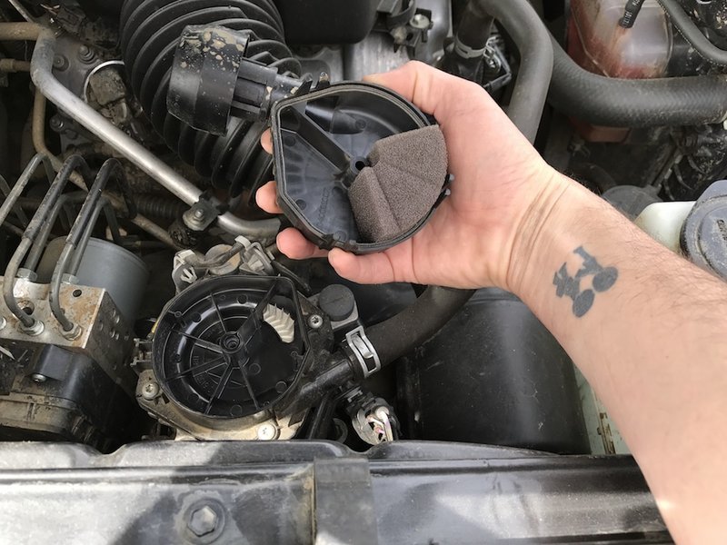

    How do you get the cover off too get the foam out ?just by removing the screw,I have a 2015

    It's easy, but 1st knock the skin off a couple knuckles and say a few cuss words. That way you look like a real mechanic. Then take the screw out, pull up-twist-wiggle and the top will come off.

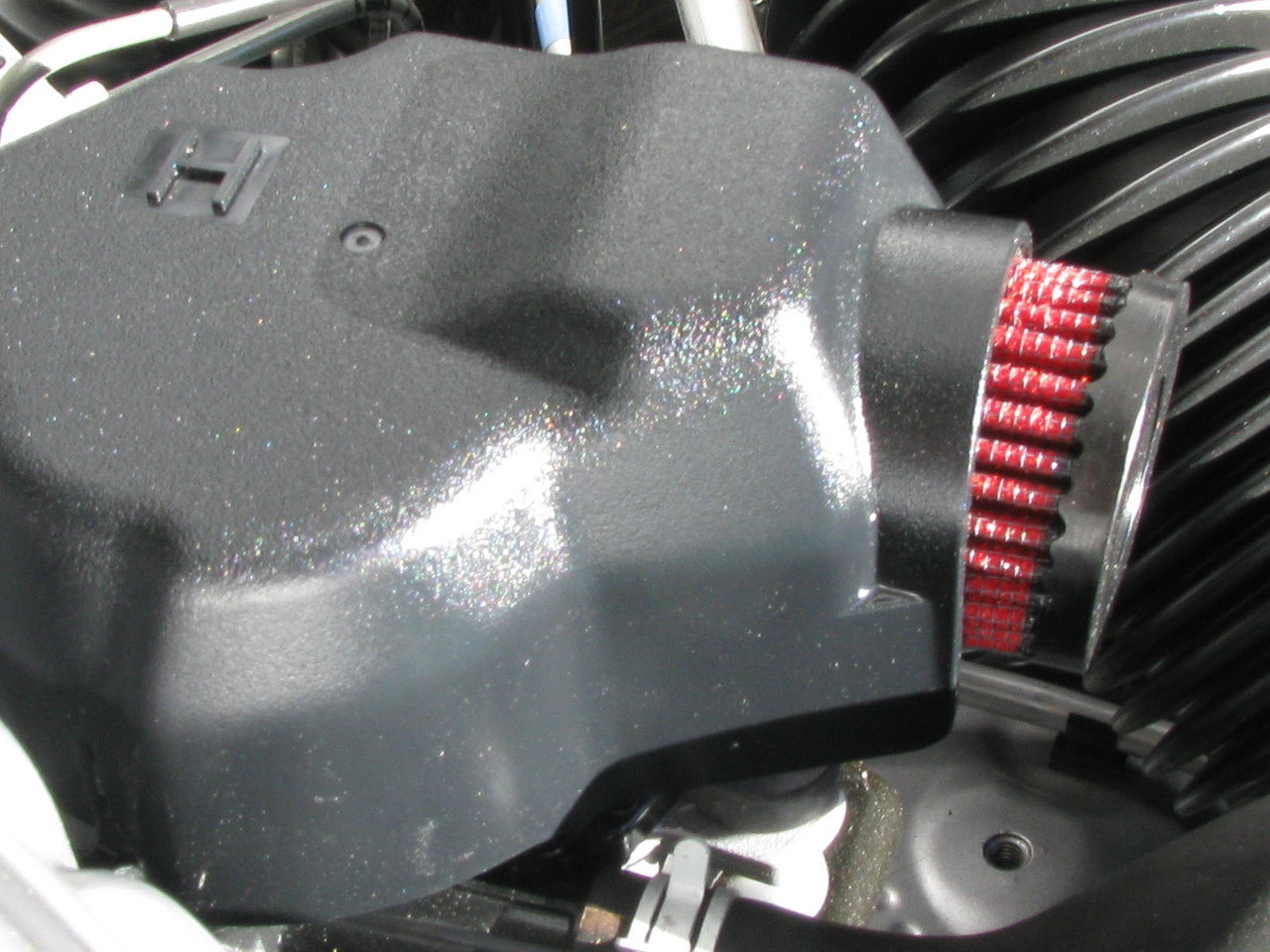

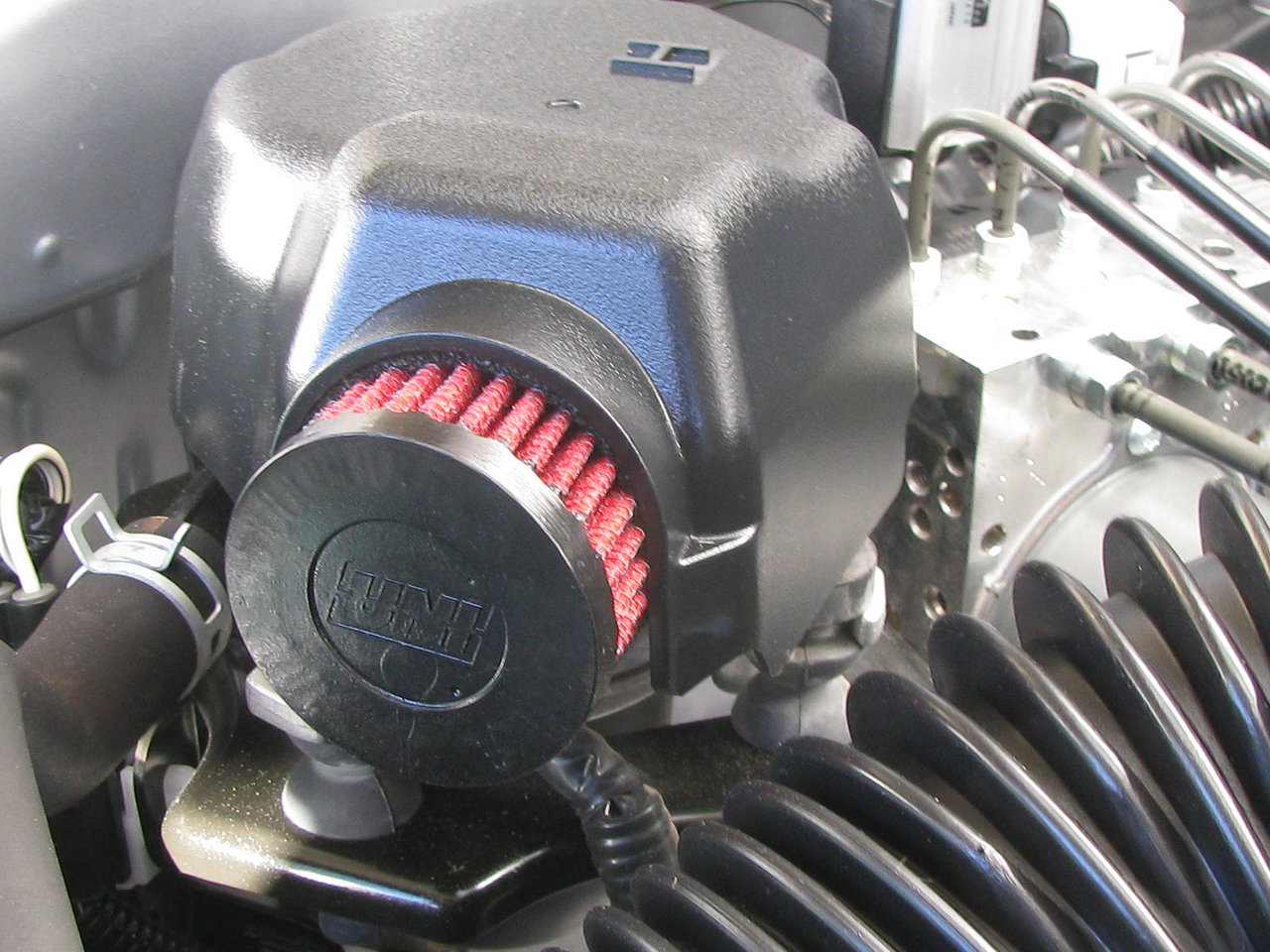

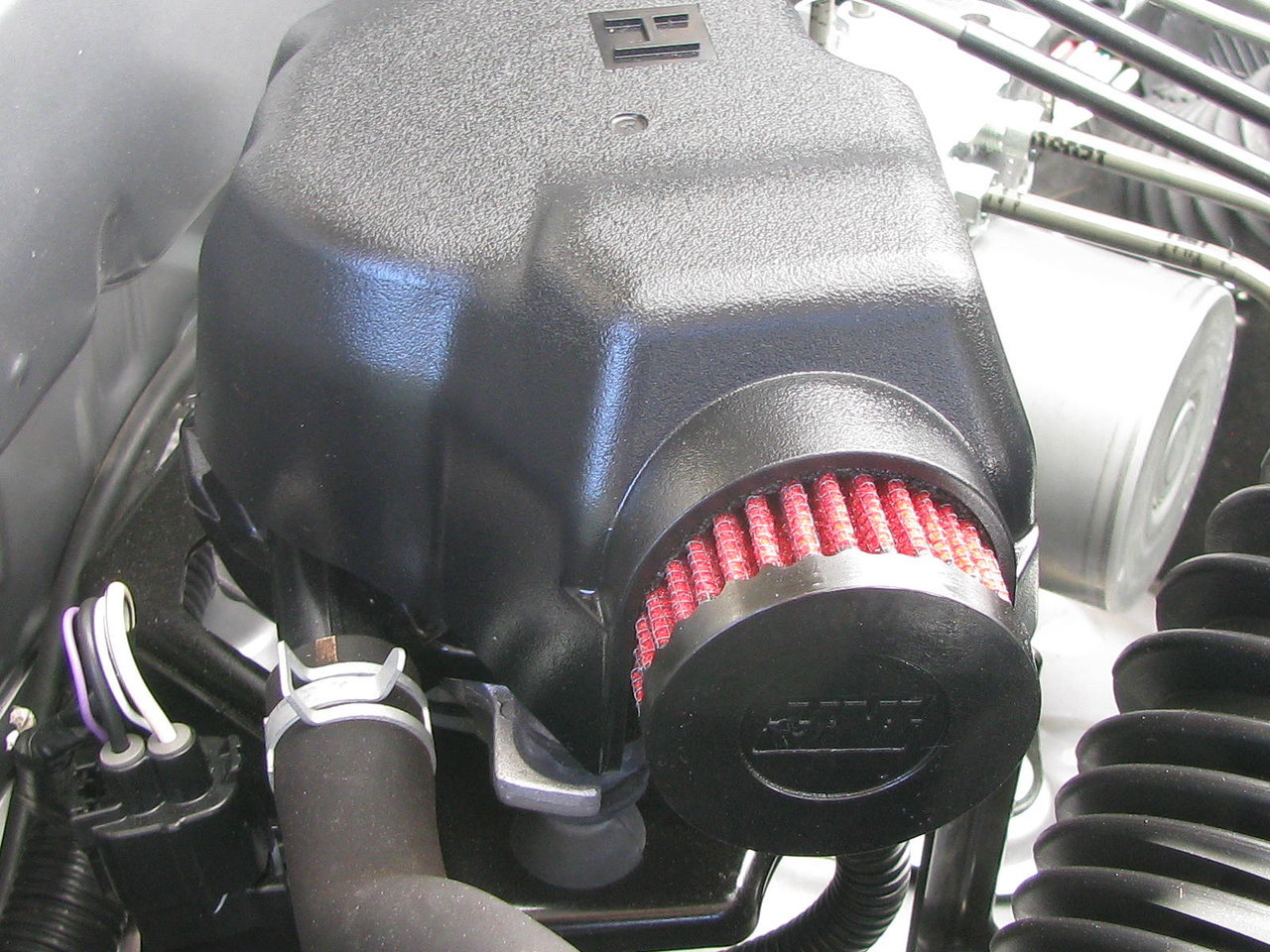

    Did the uni filter mod. today,my foam looked brand new,pictures of the finished alteration.Simply snap the cover back on with no alterations too it.nice clean look.

    ^^ looks like you could push that filter in some more so it's not exposed under the cover.

    I could push it all the way in,but I am worried about it not getting enough air flow,so what do you think.

    I've had mine pushed in flush for about a year. No issues yet.

    I will go ahead then and do mine all the way in.Thanks Alexely999

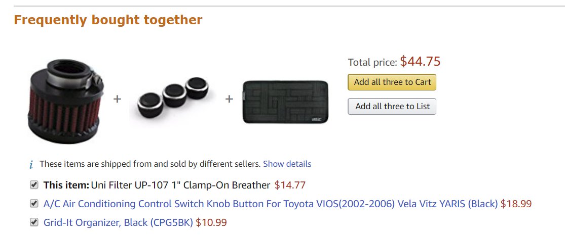

    Does anyone know of any other alternative filter for this mod? Twice I have tried to order this from Amazon and I keep having "shipping" problems.

    Anyone else think Amazon is trolling TW???

    Haha most likely we are just buying those three items after browsing TW and getting ideas.

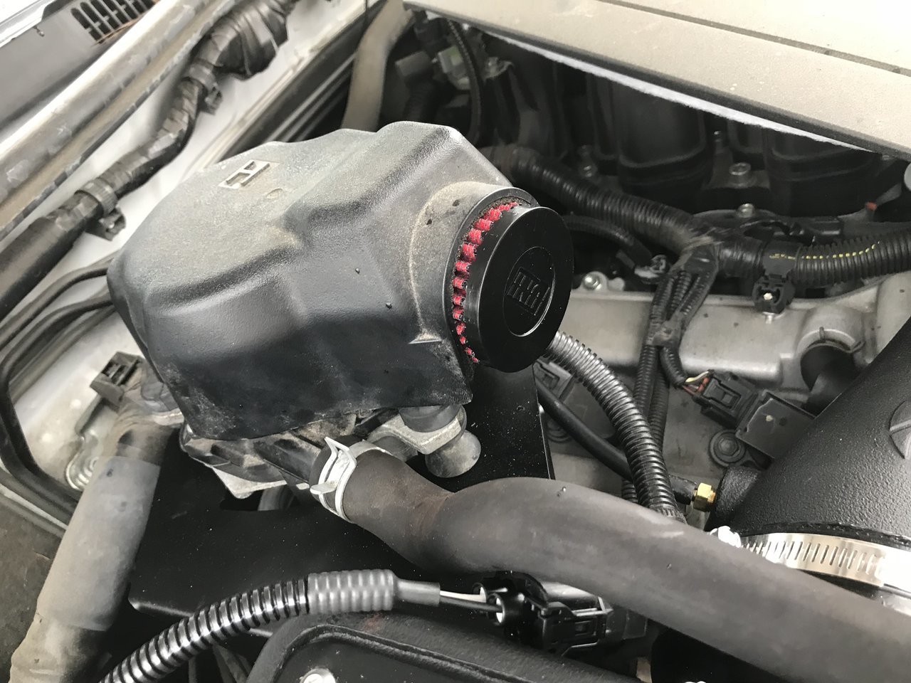

    I did this mod a while back. I feel like my secondary air pump now runs longer at startup. Has anyone else seen this? I was thinking that maybe a similar filter that allowed more airflow would improve this. What are your thoughts?

    I have a 2014 four cylinder. It has the cap over the pump assembly. I can find one "clip" near the front of the cap. I have pulled the clip out enough to clear whatever it hooks on to. I still cannot get the cap off. It will move some back and forth but I can't get it off. I want to save it and put it back on. What am I missing? I am sure it is something simple but I sure can't see it.
