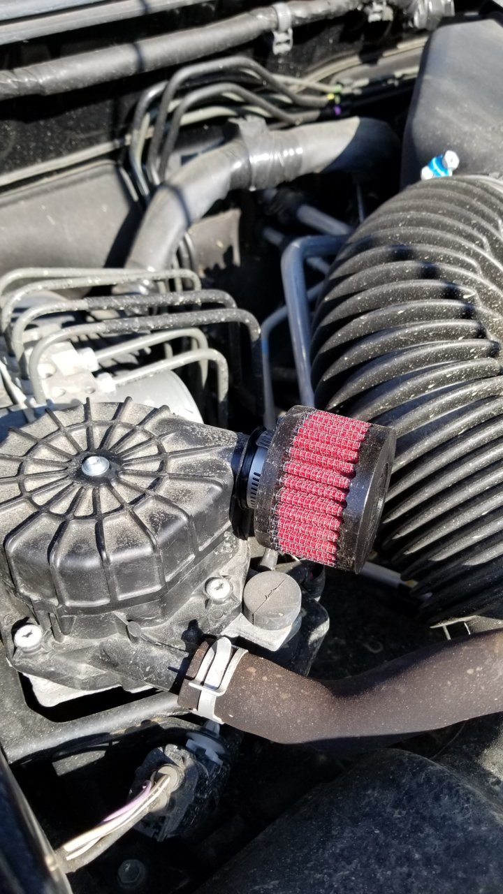

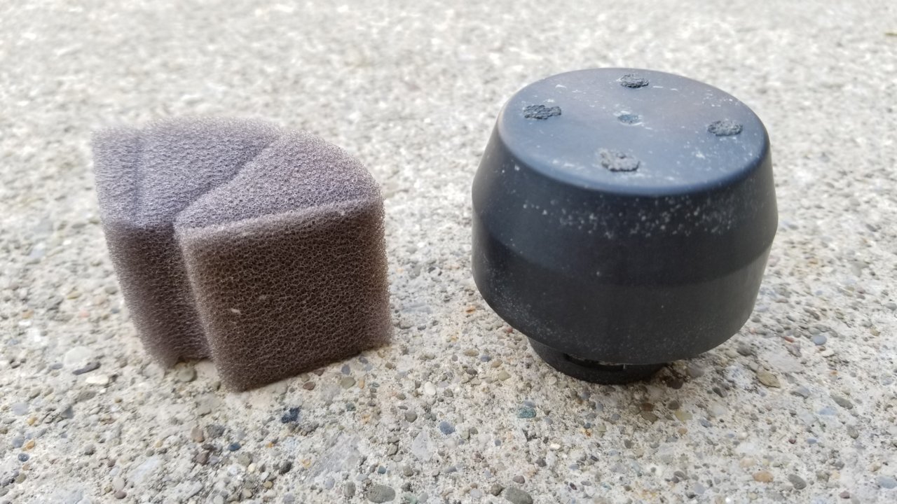

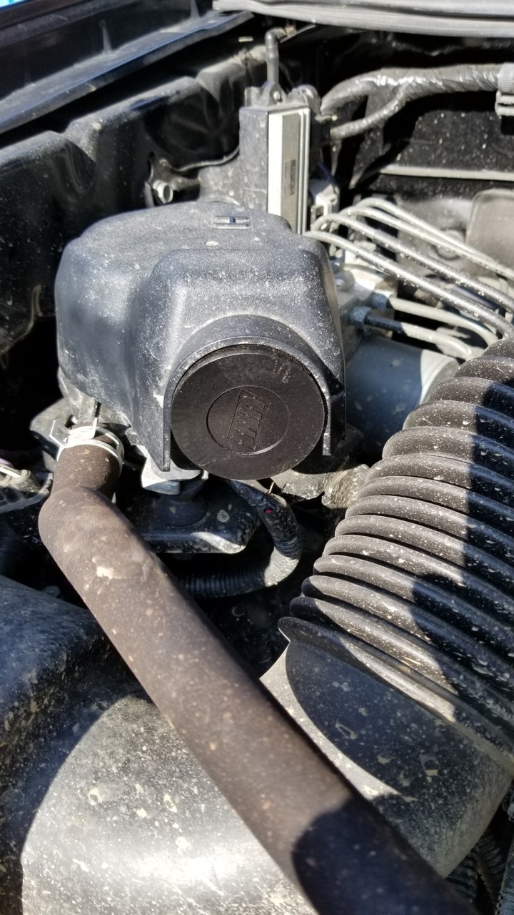

    Mod done. Super easy and no screwdrivers needed to release the round inlet cover. Just pull straight back on it and it pops off. My original filter was in like new condition and I have 70k on my 2013. I'm wondering what the catalyst is that causes some to degrade and others to look and feel brand new.
    Oh well. It's done and now the air pump sounds like a jet engine!

    I did this mod this week, and I have a question. I've read here that it's slightly noisier with the mod, but, mine seems to be quieter? It might just be me, you know how when you do a "Mod", you expect a difference. LOL. Truck runs great and I'm glad I did the mod. My filter looked fine until I lifted it out, very brittle and little pieces came off when I touched it.
