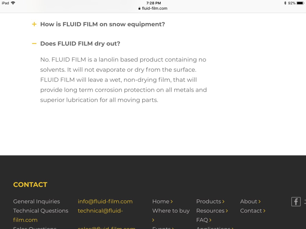

    . That’s the right data sheet. I buy it for undercoating. I have been buying it by the gal. The small amount I use to moisten the foam is not a concern for me. Foam is also made from petroleum products,thus the problem with it drying out and breaking down. It’s safe for automotive seals and electric wiring and rubber tubing under vehicles. I’m sure there are other products one could use to lube the foam, the FF was just my choice since I have been using it, and it know it will retain its liquid form and not dry out. True foam filter lube has petroleum products in it also and they actually require a solvent to clean where you can clean FF 100% with soapy water and that tells me it’s a pretty mild product.
