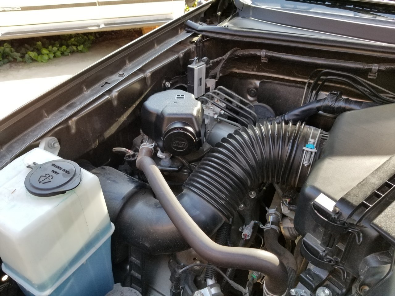

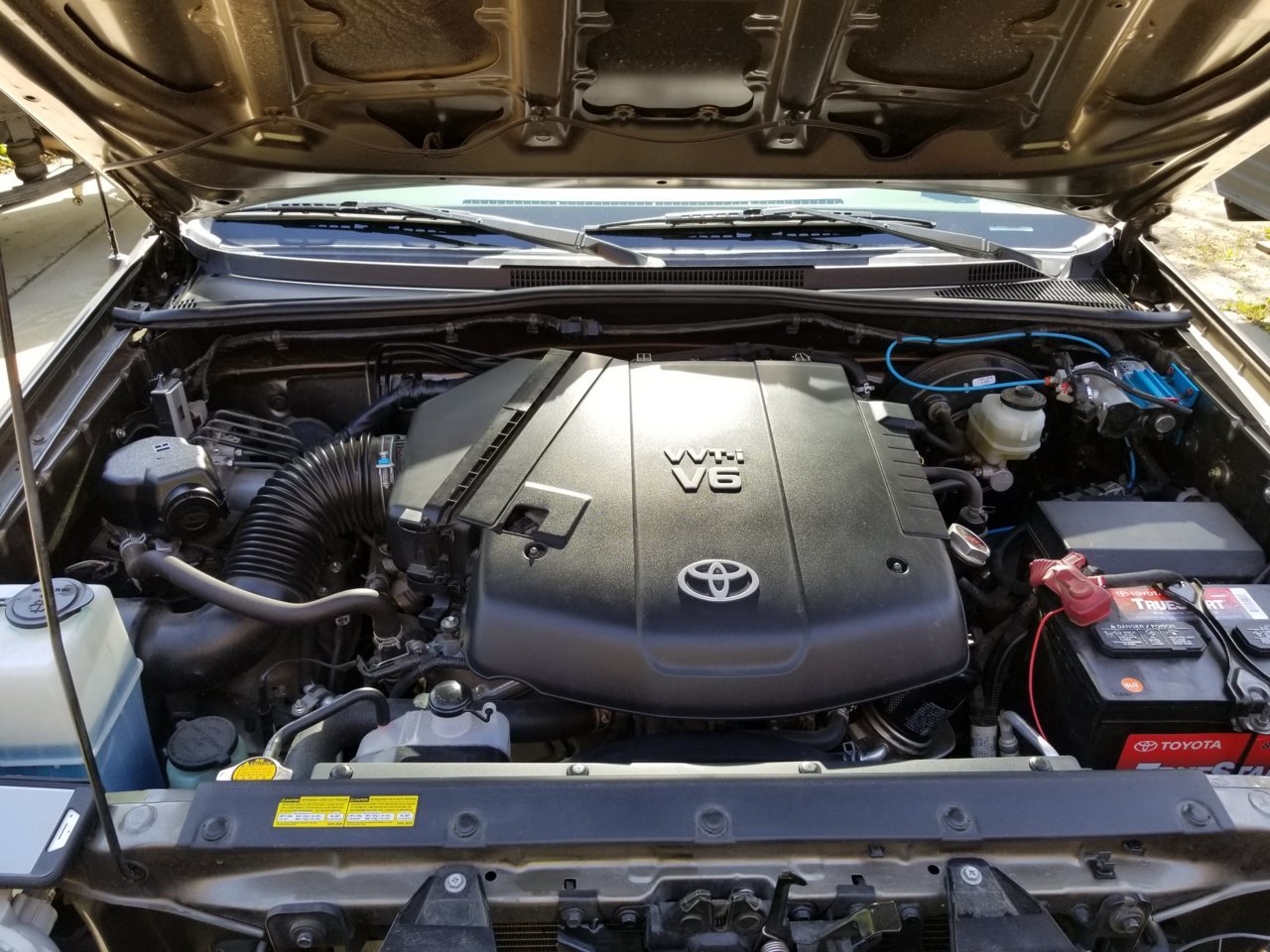

  2. Apr 1, 2019 at 7:35 AM
    #462
    Mully
    Mully Well-Known Member
    Feb 12, 2014
    #122907
    5,270
    CA
    12 DC 4x4 Lifted Sport
    Lifted, Kings, Locked, 295s and more.
    Just did this mod yesterday. Foam filter was all hard. Glad I finally knocked this out.

    Looks good. I am jealous of your clean engine bay. As soon as that part of my warranty expires, I plan to do this mod too.
