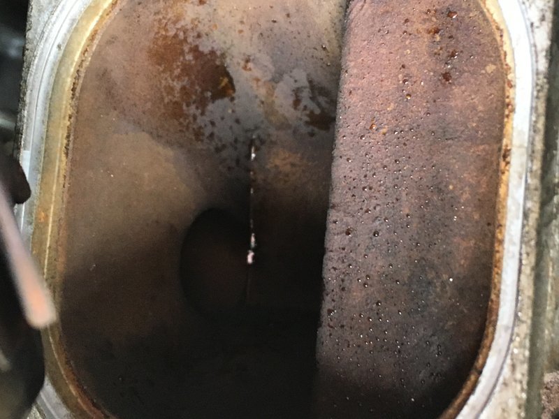

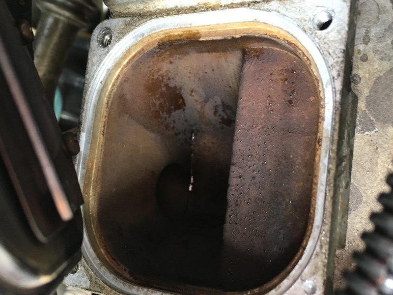

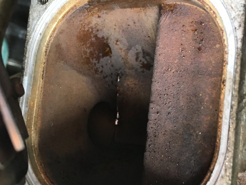

    Speaking of valves and moisture. When I was installing the bypass for the system I decided to look behind the valves just for giggles. Keep in mind my truck had been out of commission for close to 1 month while I waited on Toyota Corp and the dealer to do something. Fed up with the waiting game and getting rides to work I decided to order the bypass. Just wish I would have done that sooner.
    Anyway here is what my valves looked like after a month...still had moisture behind them.

    Distinct Offroad light bar, Rigid E-series and amber duallys, Leer 100xq, Oem roof rack, Oem bed mat, Bullculla trailer plug relocate bracket, Rear diff vent mod, front mud flap chop, Color matched Grille w/Andres devil horns, Wet okoles and weathertechs
    That's how mine looked as well, one thing is for sure they all seem to go about the 48k-55k mileage range it seems like.
