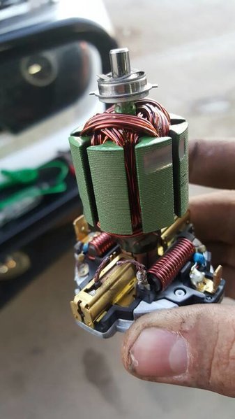

    There is also this problem. I had less than 50k(also a 2015) when mine took a shit. Instead of spending $800+ list price on one I fixed it.
    The real annoying problem is the second time it went out I couldn't find a single thing wrong with it. It just stopped. So I called up my Toyota parts guy and got one for $550(I run a body shop)
    But, if you have one go out for the first time, it don't hurt to yank it apart and see if it's those leads, crimp em back together with a tiny crimp, and put it back in. It only buys you time, but for a few pennies it went another 15k.

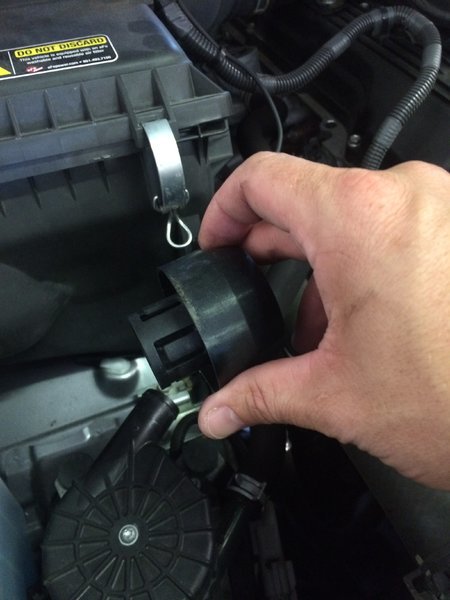

    Is the filter in here? Because nothing in this.

    This I just popped off pump

    There is no filter in mine

    so i pop this off and install this?
