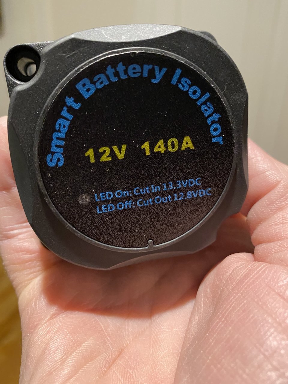

    If you're looking for an I expensive alternative, get an isolator and run some wire from your battery to the bed with a circuit breaker on the end near the truck battery. I have the isolator mounted in the bed cubby along with a fuse panel for the lights and usb/12V plugs.

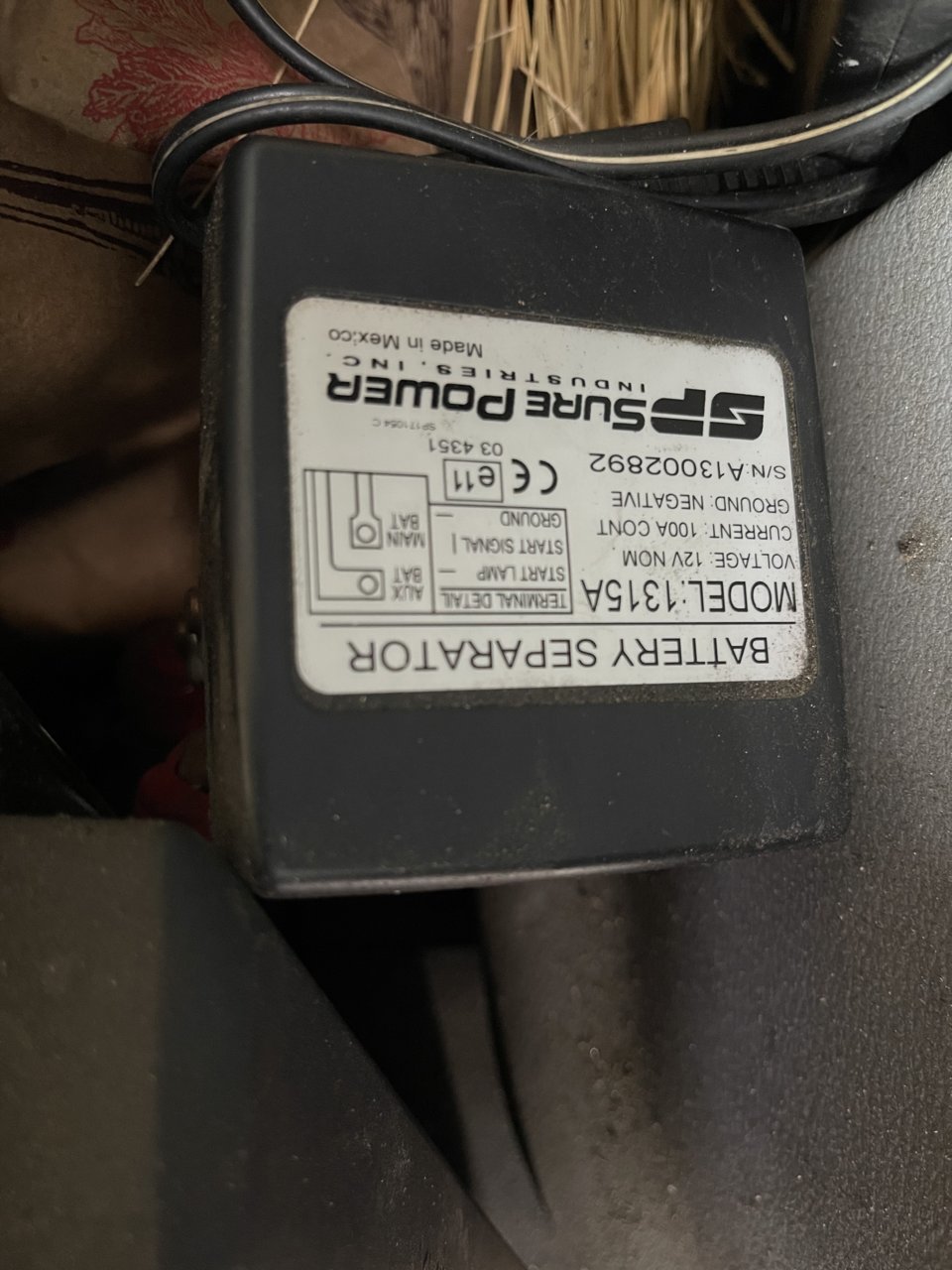

    A dc to dc charger would be ideal, but yes not cheap.
    My Ford transit came with a isolator similar to what stickyTaco pictured. It charges a second battery for a gas powered air compressor.
    The cheap way would be to run a cable to the bed from the primary battery with a short ground cable at the secondary battery. Even if you use a small wire like 10ga, it’ll charge better than a trickle charger. Of course a breaker near the primary battery will be a safety must.

    This is the battery isolator in my Ford transit, I believe factory installed, so probably the cheapest one they could find. It seems to work. The second battery is always charged up, I can jump start at the second battery. It makes a loud click when it turns on and off.

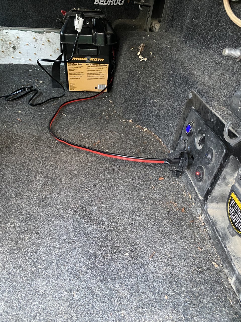

    I have a small battery that fits in the box next to the inverter. It's not huge, but keeps my laptop and phone charged while camping for a weekend. Mainly I will fully charge it at home, but also turn on the inverter to keep it topped up while I'm driving around if I had discharged it a bit. It also powers my shell's overhead LEDs. I chose this one for its dimensions. It fits nicely in the box, with a little extra room for the AC plug and an phone charger cord.
    It's a pretty nice thing to have when camping. A slightly larger capacity would be nice. And like others said, the inverter can't charge very fast.
