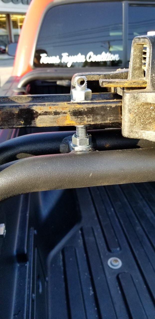

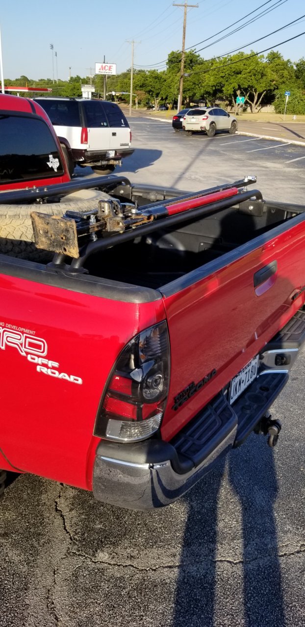

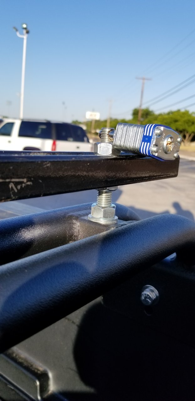

    Here is how I did mine. Bought some hardware at Ace and drilled holes through the bolts at the end to put padlocks through. Turned out pretty nice. If you go this route have patience when drilling. I did it free had but if you have a vice and drill press it works best.

    I was trying to find a padlock wide enough to go through the holes of the hi lift and through the bed rack but couldn't find one that fit my needs. And a cable version just wasnt gonna work either. So this was my solution.

    Yeah they were cake for me. These aren't grade 8 or 5 hardware since they just need to hold a jack. No load or real strength needed. Not sure what grade they were but they were from the metric section of ace hardware. Wanna say they were the 12mm bolts with a 19mm head on it. For perfectly through the holes.

    Patience my friend. Patience hahaha I did it by hand with a very small drill and just slowly stepped it up to bigger drills. But like I was saying if you got a vice to hold the bolt and a drill press then you can use a bigger drill bit and just go to town. I think the all the hardware cost a total of 12 bucks. So even if you mess up a bolt or two you arent out much.

    Hell yeah! So I bolted them down to the bed rack to hold the bolt steady and it helped for sure.

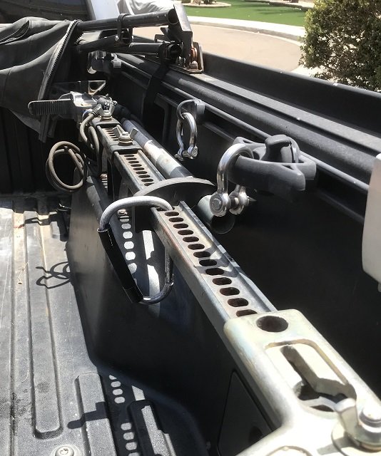

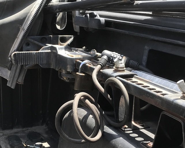

    You don't need a bed rack to mount a Hi Lift, although I am shopping for a bed rack myself, but will not install a Hi Lift on it. I'm using Hi Lift brackets - 4XRAC. I mounted the brackets on the wheel wheel; the lift is black and does not stand out. I have two locks on it: a Master combo lock fits nicely in the rail; and a cable combo lock goes through the brackets, and also through the lock on my storage box, although at the moment it is not installed.
