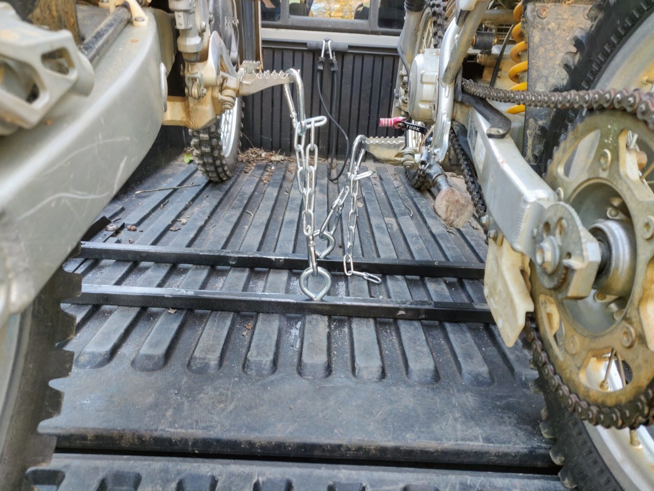

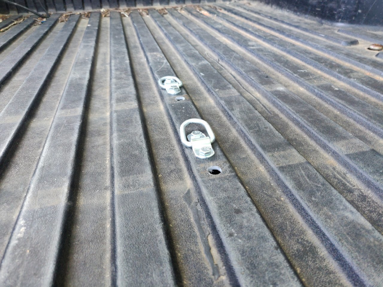

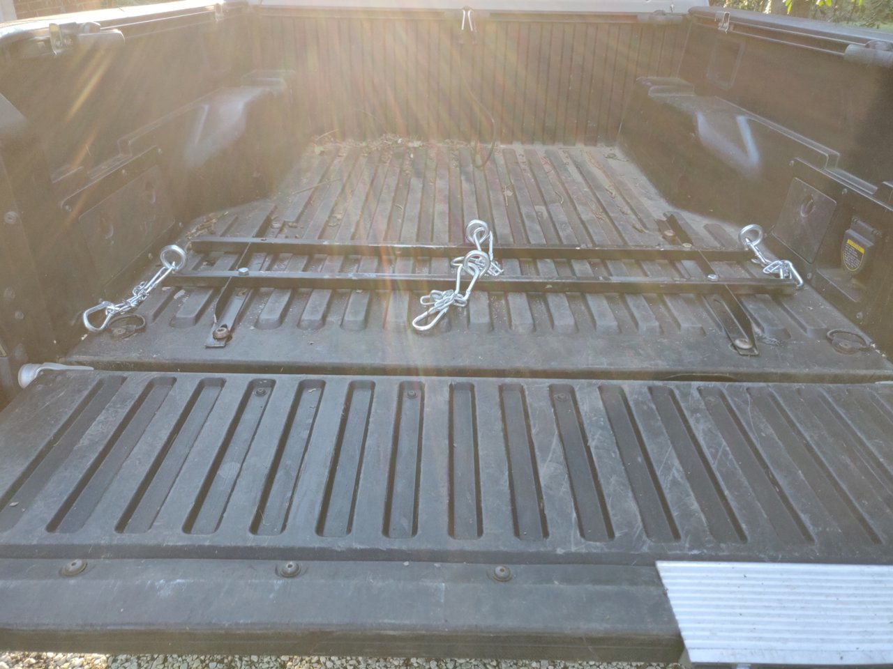

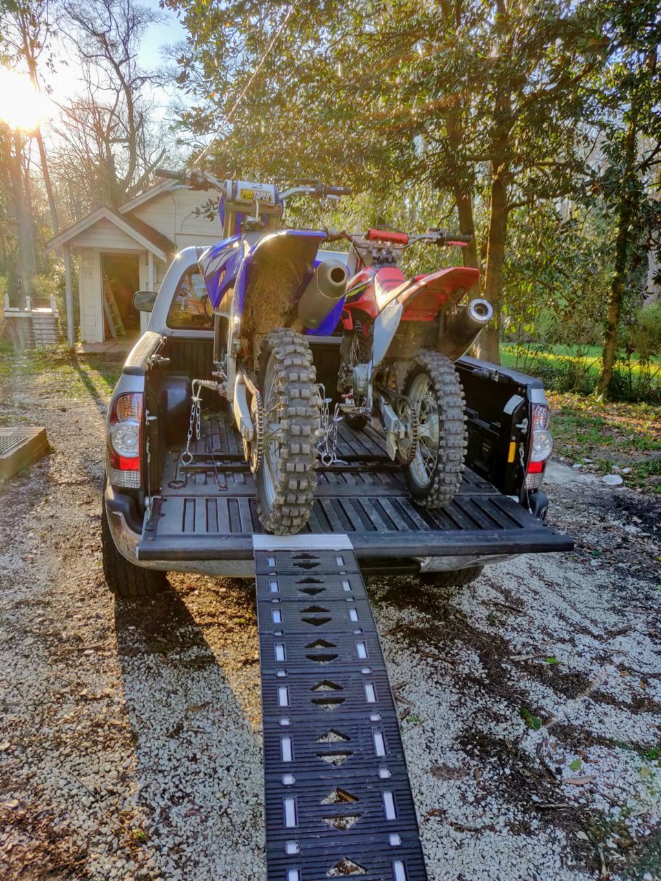

    I recently changed this set up I'll send a picture. Riding lawnmower would hit the eye hooks, bout died loading it haha. By far the easiest way to secure a bike though.

    Nice set up, I like the idea of going to the door pegs. Local tracks race team uses a set up like that in the race trailer.

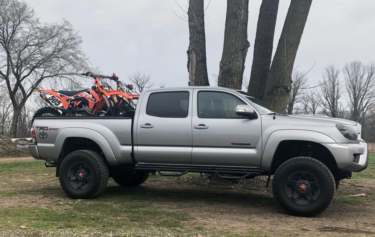

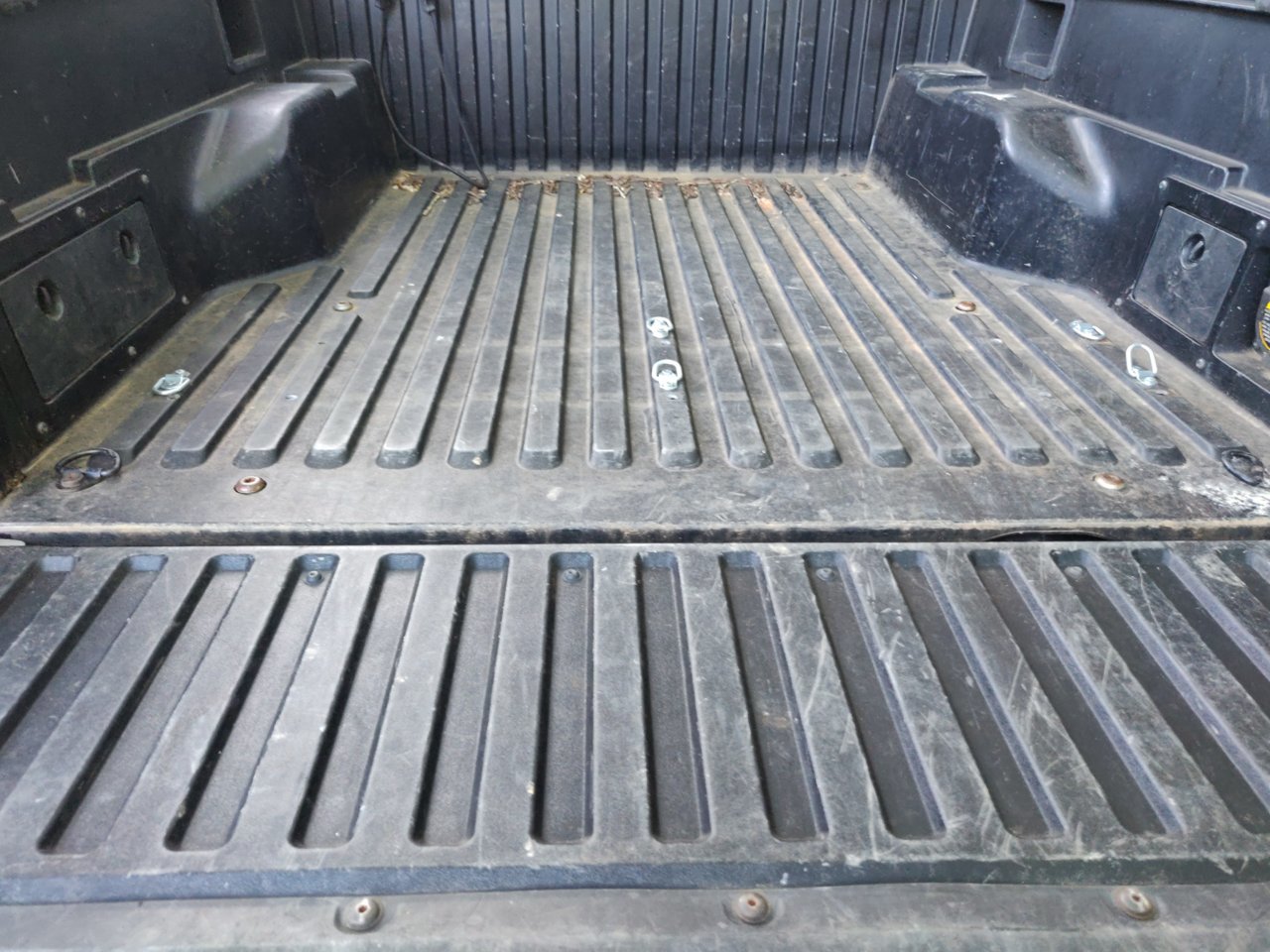

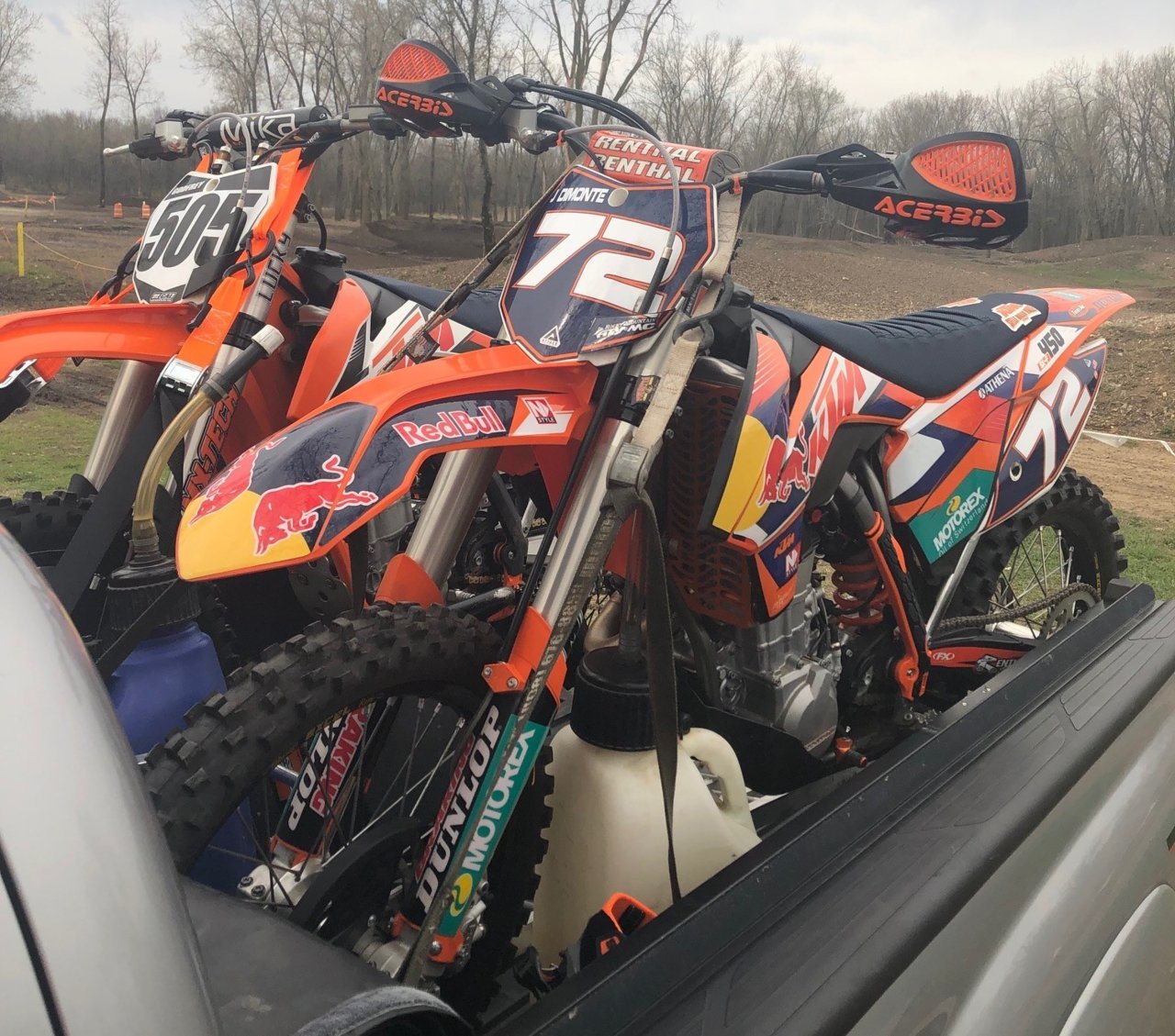

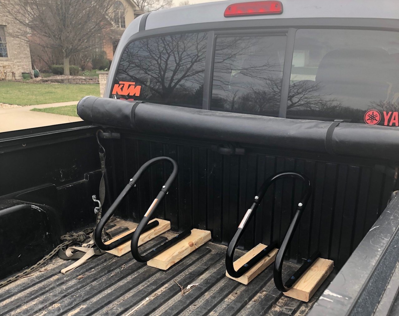

    For a 2 bike setup I just use 3 of the cleats on the rail system. I upgraded to the rhino soft ties after these pix were taken but i made some chalks and try to line the front wheels up in the bed grooves. Single bike I go just 1 diagonal and close the tailgate with 2 straps in the middle of the bed and the one about 2 feet from the left corner on the rail system. 58,000 miles and a lot of dirtbike hauling and no problems. The new rhino straps I got I really like you can see 1 set on the 505 bike but they are a nice soft tie.bike chalk2.jpg tacobike1.jpg
    also the strap locations and such have made it easy to get my loading process down to a science. I run 1 strap through the rear wheels and the ramp also across the back just in case.

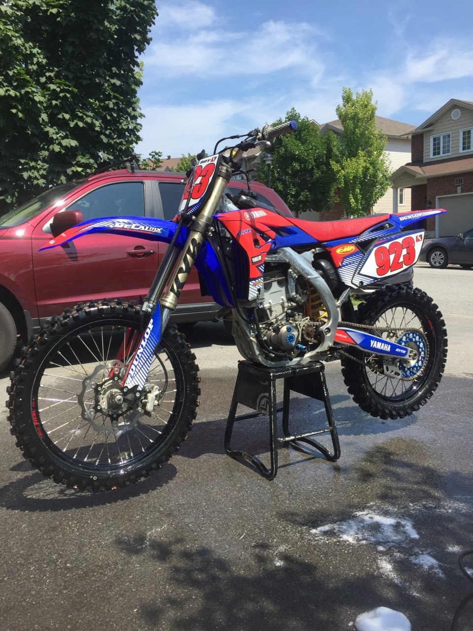

    I’ve got a 11 yz250f that gets taken down the the frame every winter.
