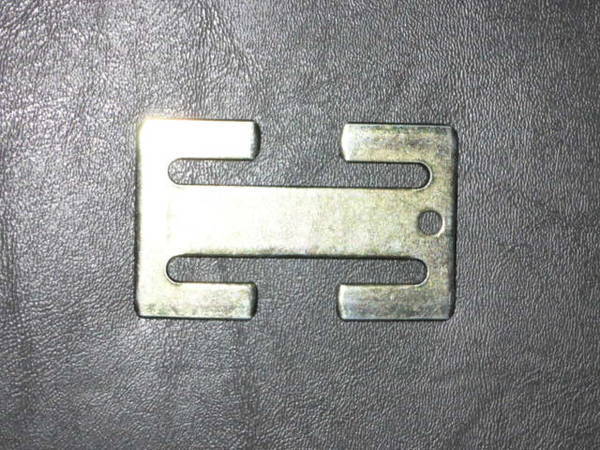

    I am new to this forum and i really appreciate the ideas and advice. A couple of you mentioned some sort of metal strap that secures to the seat belt/seat belt bolt that than can serve as an anchor - if you have any further info on what this is called (assuming it is an actual product i might be able to buy) let me know. Thank you.

    This is the device that locks the seat belt. It should have come with the car seat. Check out the manufacture's web site to see if you can get one. If not let me know I can send this one to you. I have the latch system in both my car and my truck.

    thanks for the picture - very helpful.
