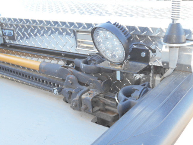

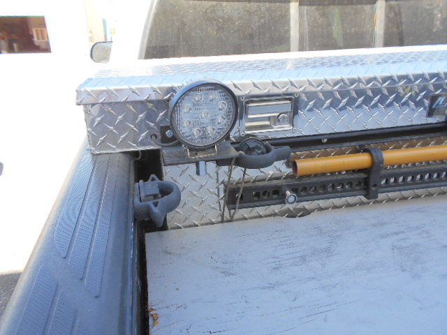

    There is always room for invention.....on my old service trucks we often mounted stuff on wheel studs (that matched the truck lugs) clamped down with lug nuts. So when I mounted my jack on the tool box - I made stud brackets that use the same wheel stud threads as the Taco. Then put some Gorilla locks on them that were also sized for the truck.
    They have an integral cover (that spins) to keep off the visegrips. I keep the "key" socket and a sawed off Chinese box wrench in the tool box tray.
