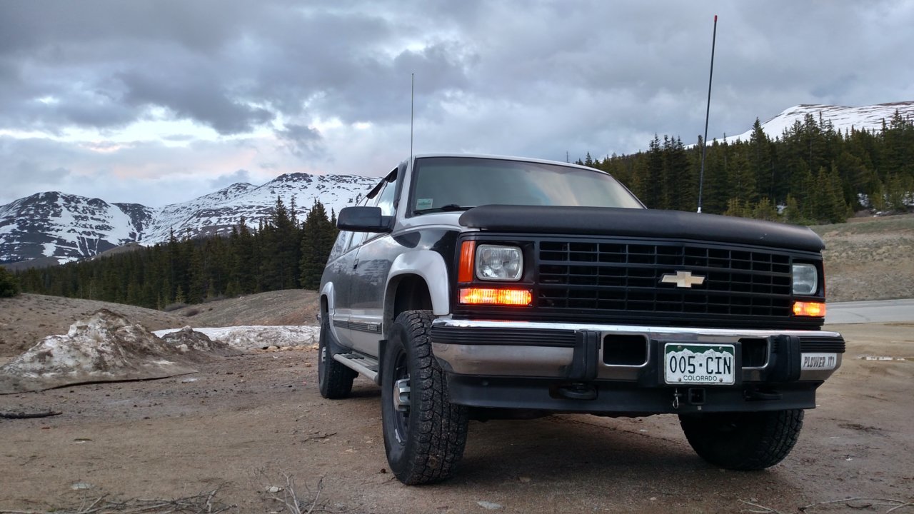

    When I replaced the fan clutch on my '94 6.5TD Suburban, when it got hot enough to engage, it sounded like a helicopter!
