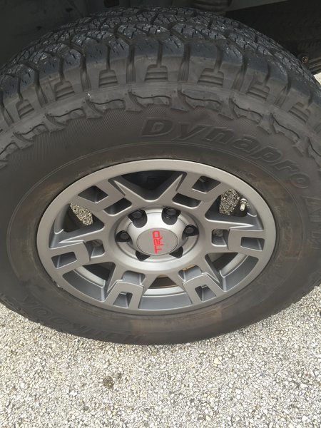

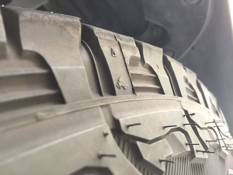

    I have some very badly cupped hankook dynapro ATMs with only ~15000 mi on them... Hard to say exactly what caused them to cup, but I think poor alignment or an absolute spring board of an aal may have contributed. Either way all of suspension is redone. I've heard cupped tires will never be the same unless you get them "shaved", and believe it or not I can't find a single tire "shaver" in the Houston area. I've also heard (from people not trying to sell me new tires) that driving on cupped tires is somewhat of a safety concern, largely due to the periodic loss of traction. So I have a few options:
    1. Search far and wide for a tire "shaver"
    2. Bite the bullet and get all new tires
    3. Keep them, hope they smooth out with frequent rotations, and pray they're safe enough to handle Houston weather and traffic
    Your thoughts / experiences? Thanks image.jpg image.jpg

    Cupping occurred with new 5100's (front at 1.75 with stock springs), crappy front alignment due to need for new UCA's, and a harsh, springy aal. Now I have new UCA, same 5100, OME 884, and wheelers progressive aal. Overall much nicer ride in back and perfect alignment up front. I ruined all the variables for deciphering cause, but likely fixed the issue.
    Thanks for the advice everyone. Sounds like keeping them, rotating often, and monitoring would be the best solution for now. Will have to look up the chalk test. I can afford new tires, but obviously would rather not shell out

    Just to update: it looks as though the springy add-a-leafs were the culprit for the tires cupping. Basically, the overly bouncy add-a-leafs overpowered the rear struts (brand new 5100's), which is effectively the same as having blown struts, leading to high-frequency bouncing and ultimately tire cupping. Wheeler's progressive add-a-leaf pack has made for a much smoother ride and haven't noticed cupping worsening
