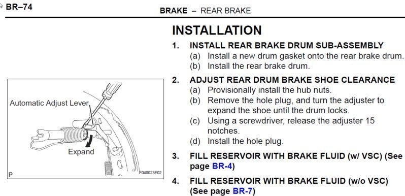

    If you didn't do it this way it wasn't done correctly:

    The parking brake is "supposed" to keep them adjusted once set correctly. But they do a poor job at it.
    For me, I like to set them to where they are slightly dragging when spinning the wheel. More than just hear it, I like to feel it drag too.

    The adjuster is activated by using the parking brake - not by backing up.
    Do above adjust first.
    At the bottom of the rear brakes is a shoe pivot that can rust solid and this moves when the parking brake is applied so free that up.
    Make sure the parking brake cables are working also and not broken.
    If the cables are stretched they can be tightened up under the center console storage box.
