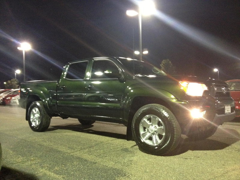

    I'm going to do a big performance upgrade to my truck this year (install all at the same time) and am starting a parts list. I've done some research on TW and online
    (Looks like URD has some good stuff).
    I came up with a list of parts and would like some feedback, and have a couple questions.
    Here are my questions:
    1) Are there performance parts I am missing?
    2) Are there any suspension mods I could make to improve body roll and corning? (Stock leaf springs with 100K miles. I drive far distances on highway to ride dirt bikes.)
    3)Anyone have any "guess-timates" for what this will bump horsepower and torque output to? (Not looking for definite numbers...just ball-park).
    4) Do you think a good independent Toyota mechanic can do this work? (We have good independent mechanics where I live, for every manufacturer.)
    Thank you,
    Micah
    My Truck: 2013 TRD Sport DBL Cab 6’ Bed V6 AUTO
    Performance Upgrade Parts List
    Supercharger (Magnuson)
    URD Supercharger Pulley
    URD Mark3 Exhaust (*I don't want anything excessively loud. Just trying to open up the flow.)
    URD Spec-U LT Headers
    URD Fuel Pump/Filter Upgrade Kit
    URD Throttle Body Adapter
    Spark Plugs (*Need suggestion for good spark plug for this set-up).
    Current Upgrades
    Bilstein 5100 shocks (front & rear)
    EBC rotors & pads (Installing next week)
