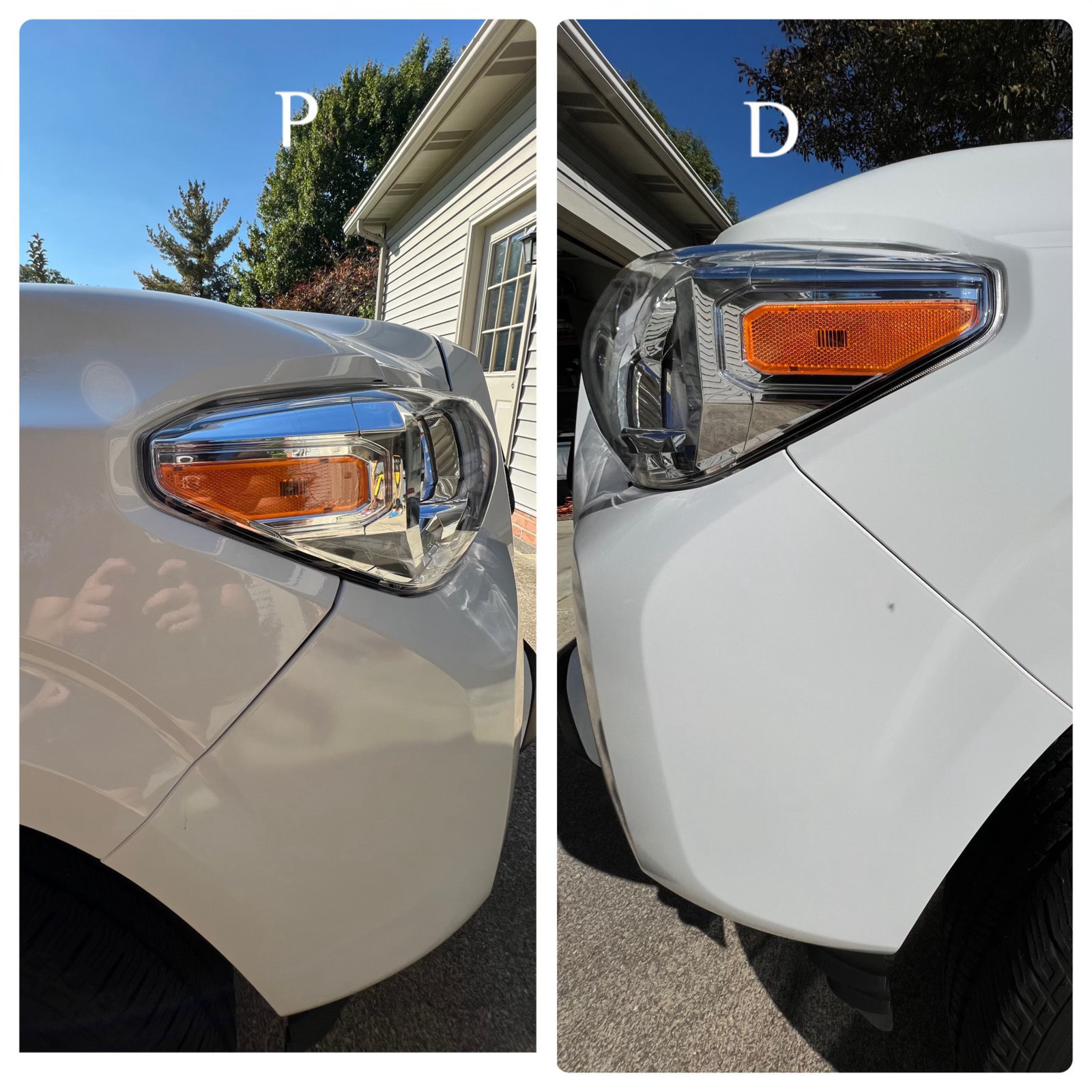

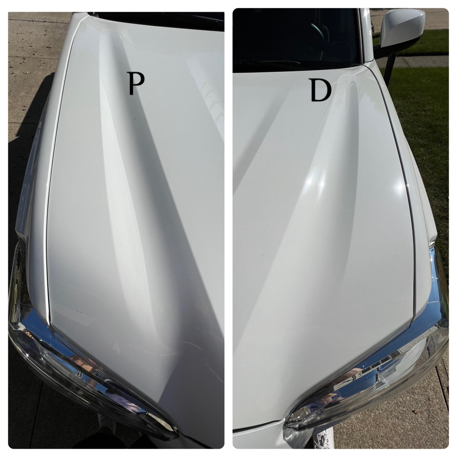

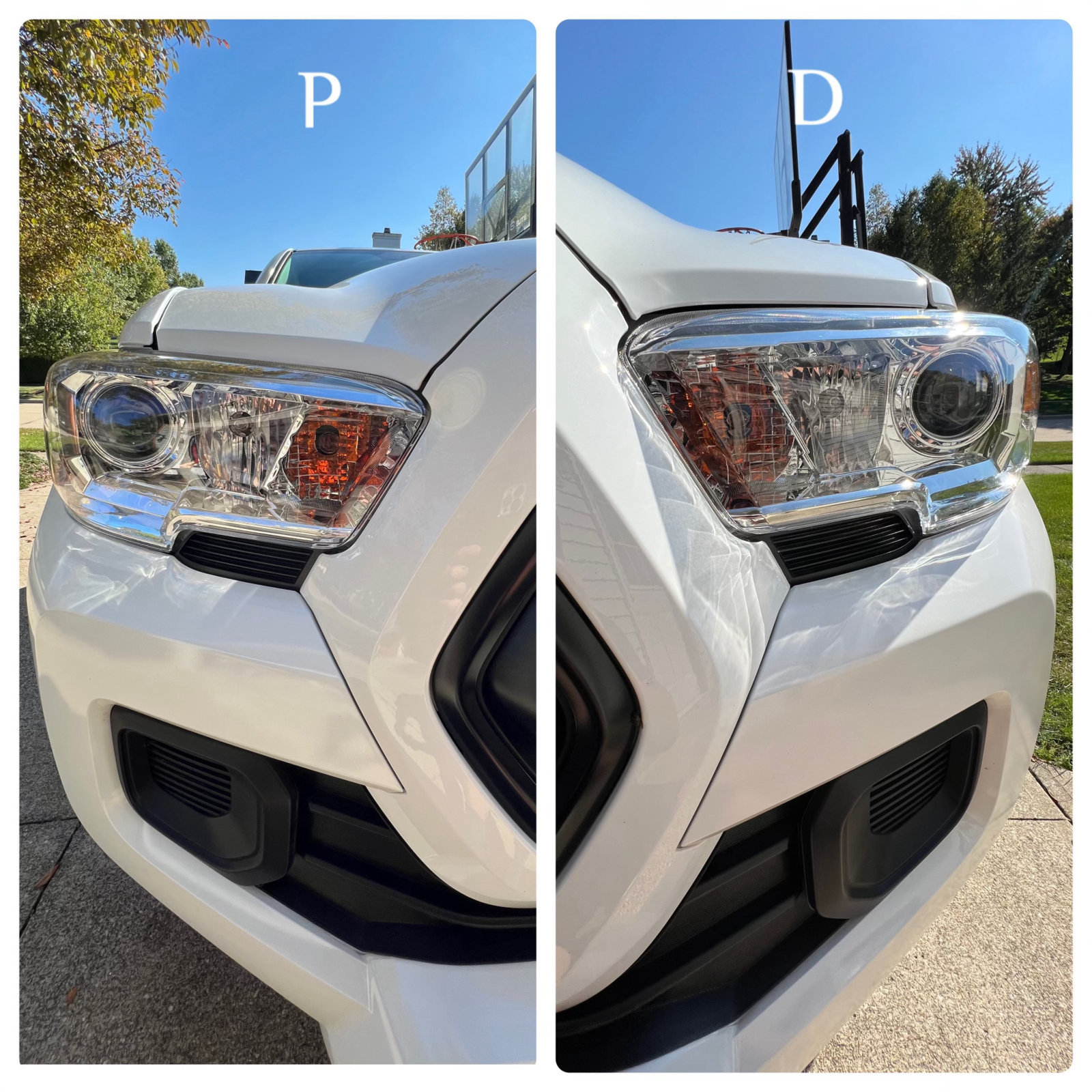

    Hello everyone! A vehicle backed into me as I was walking into the store this morning and then sped off. Upon further inspection, I noticed very light marks on the lower corner of the front bumper (passenger side) that I just wiped off. However, I also observed that the passenger fender was pushed upwards and no longer sits flush with the hood, and the bumper has uneven gapping on one side where it made contact. Is this something I could fix at home, or should I be worried about it?

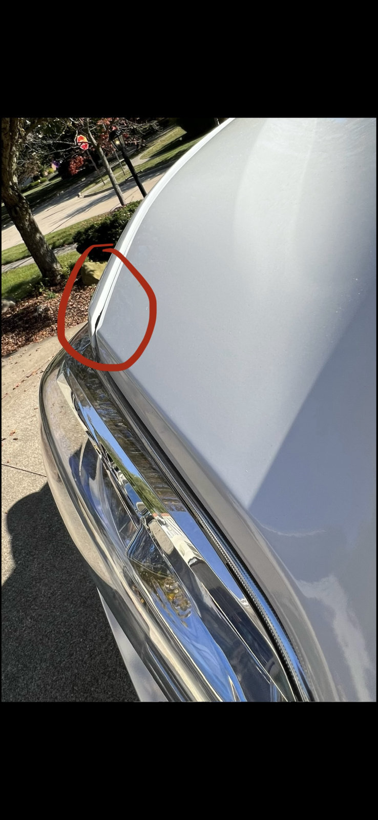

    Your fender did not move, your hood is just not aligned right. Look at the gap between the hood and the top of the headlight. Passenger side there is no gap, driver side there is a gap.
    You just need to adjust the bumper stop for the hood to line it up with the fender. Its probably always been that way, but you never noticed as you were never looking for damage until you got bumped.
    To expand, the amount of force needed to push your fender up like that would of broken clips and broken the headlight mounting tabs as well as leave a substantial damage on the bumper.

    The fender probably shifted a little when the bumper cover pushed against it. Watch a YouTube video on fender removal. Loosen all the screws and shift the fender until it's satisfactory. You'll be less picky about it when you realize the fender is paper thin and can shift/flex a good inch in some places :laugh:
