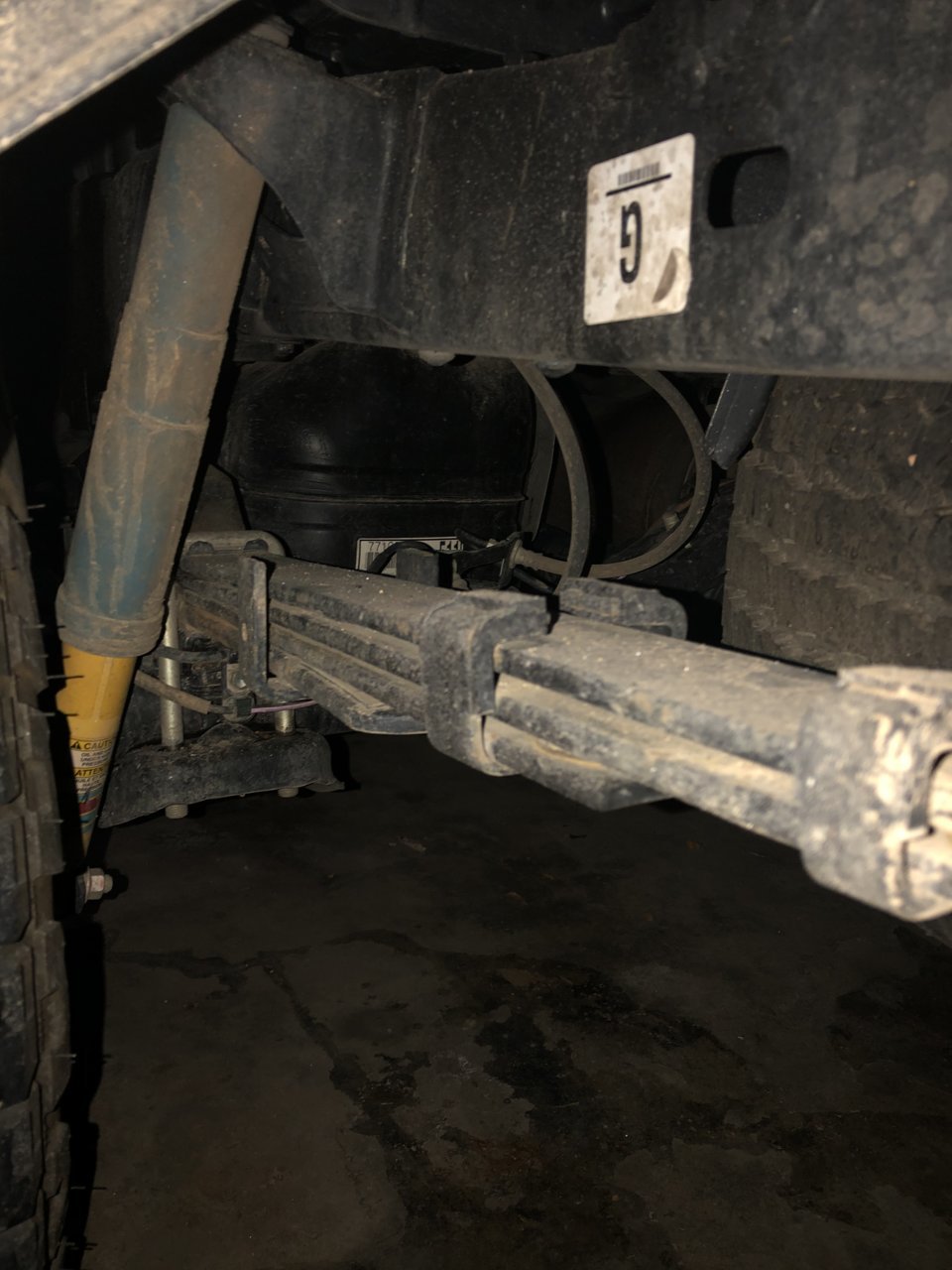

    Here is a pic of my stock leaf pack in an unloaded truck. I'm bottoming out going over railroad tracks! The pack lost its will to live on White Rim Road. I'm patiently waiting for my call from the shop that my 112s are ready to go...IMG_5798.jpg

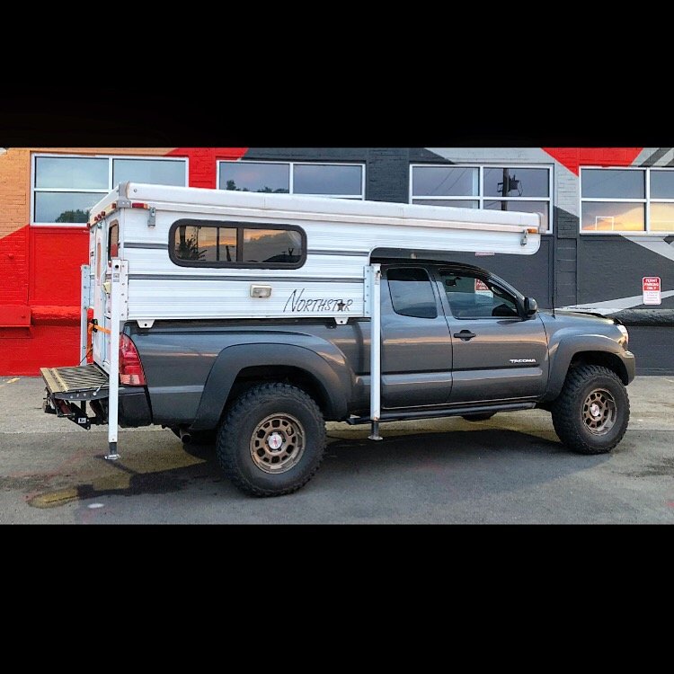

    I have 111R's w/ super bumps and Toytec Boss struts. Topper picture is probably ~800lbs and camper picture is ~1400lbs. With the camper I still have about 2 inches before hitting the bumps. I installed this March and have about 10k miles now and honestly impressed, they handle the weight very well and are still compliant off road. Truck feels slightly too stiff with no weight in the back, but it's rare that it's empty.

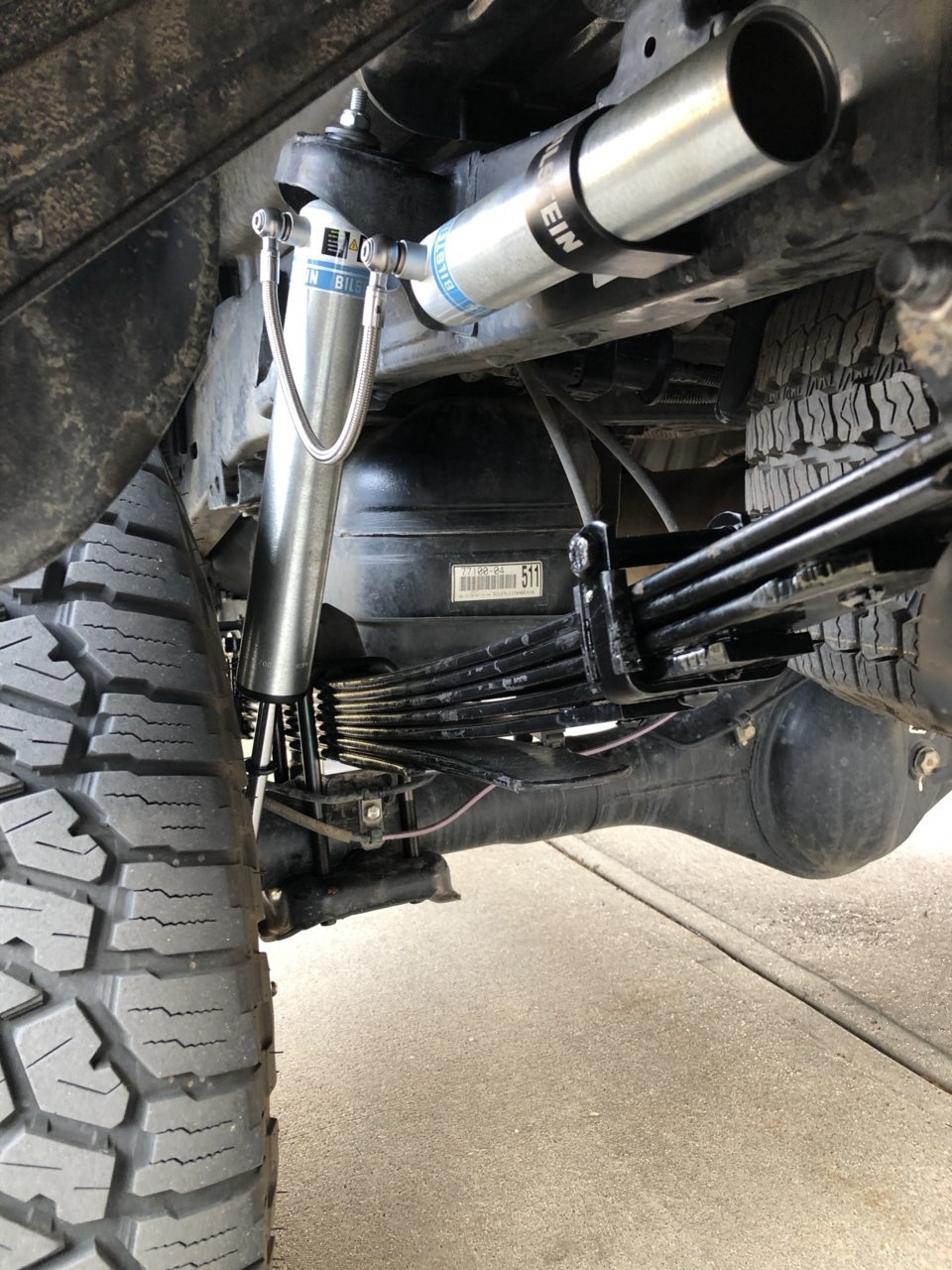

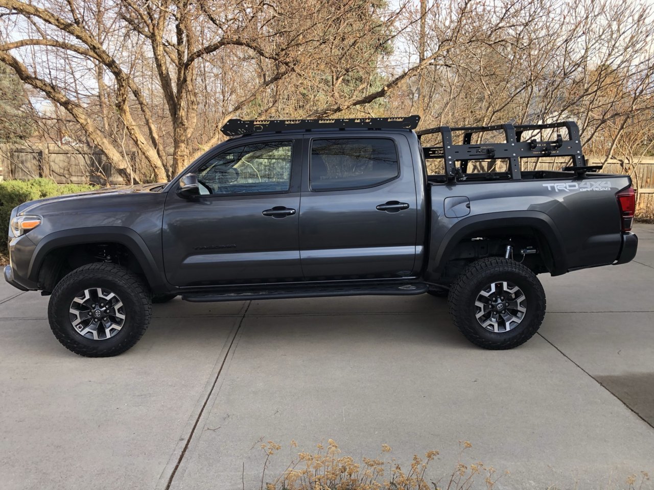

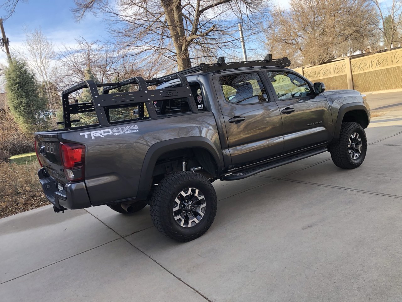

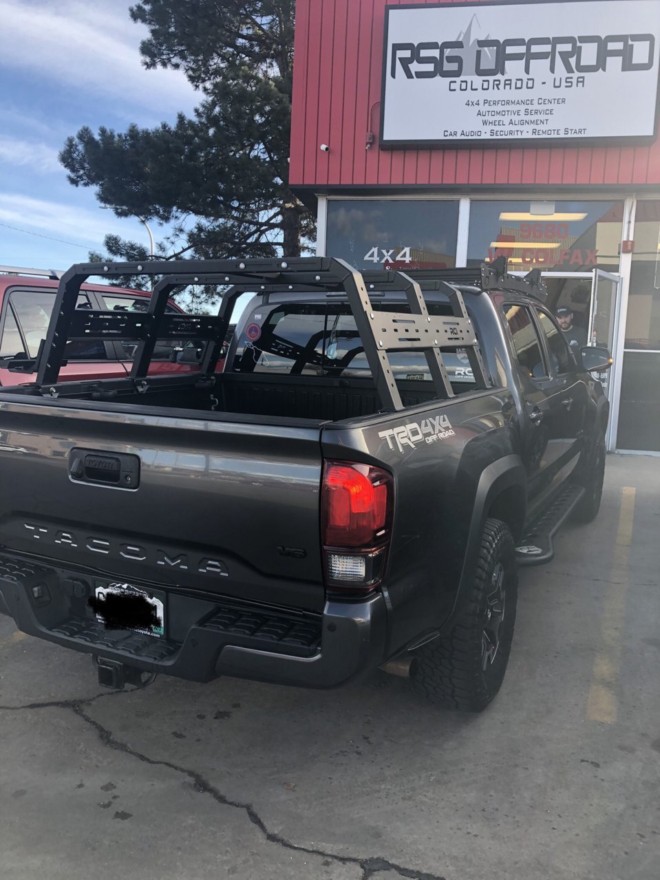

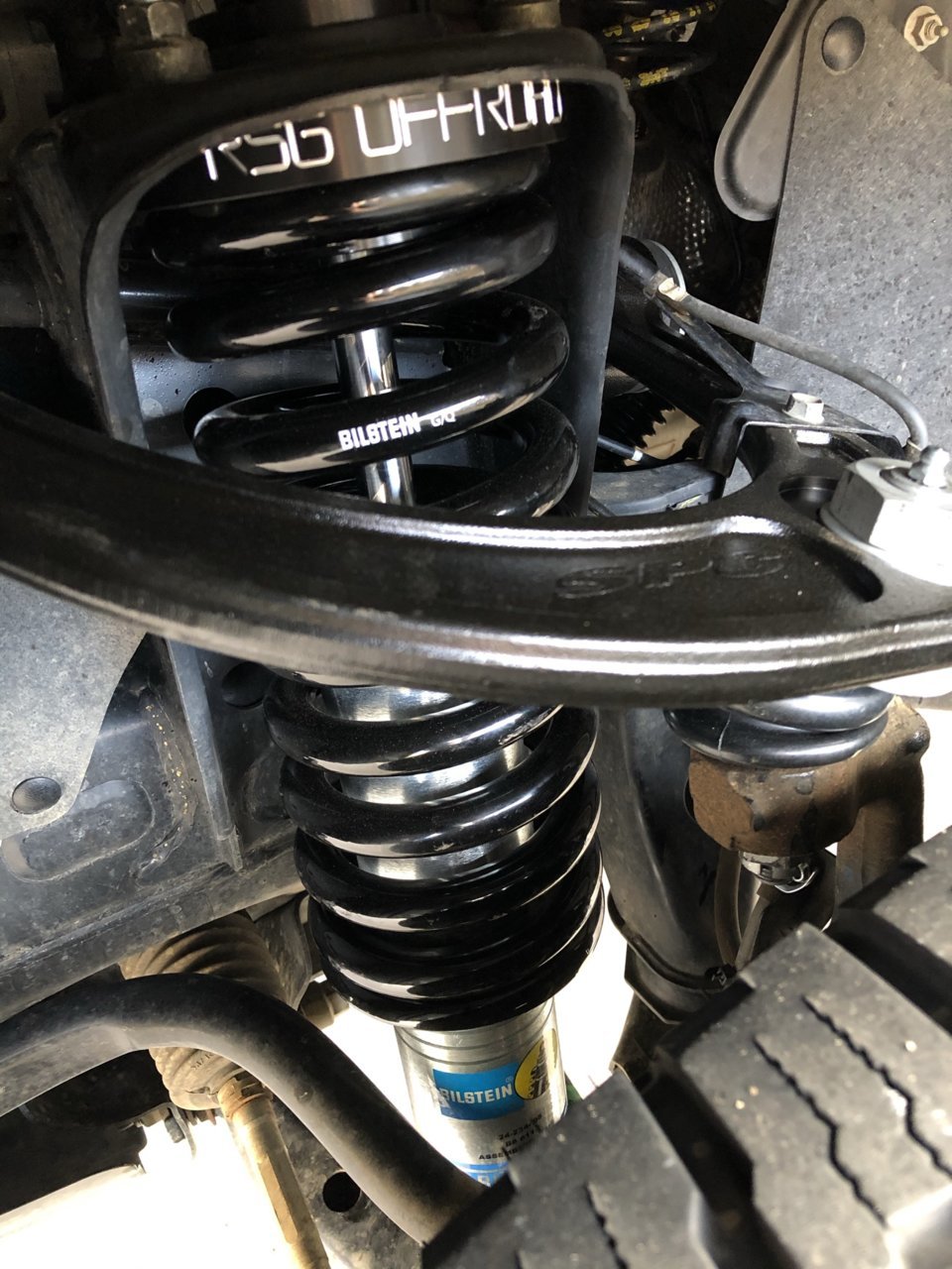

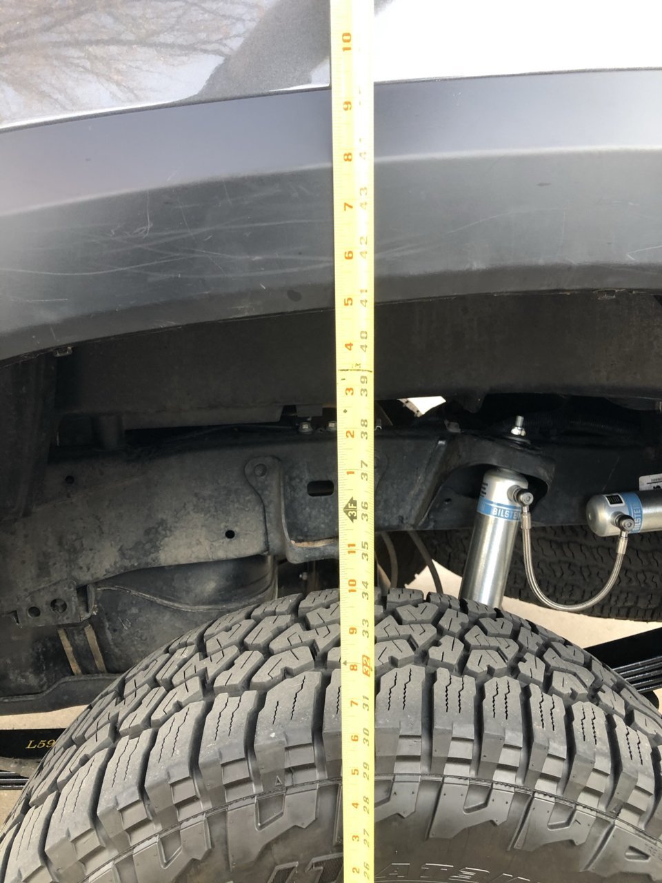

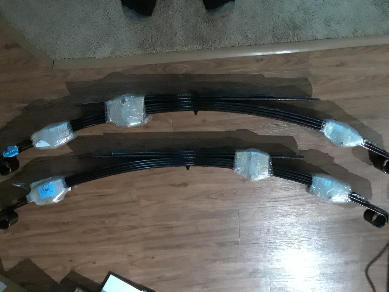

    Got the truck back today!!! I was worried about the 112s being crazy firm, but it isn't too bad unloaded, but it did need shims to get rid of the vibes. Bilstein 6112/5160 are pretty :) Super excited!
