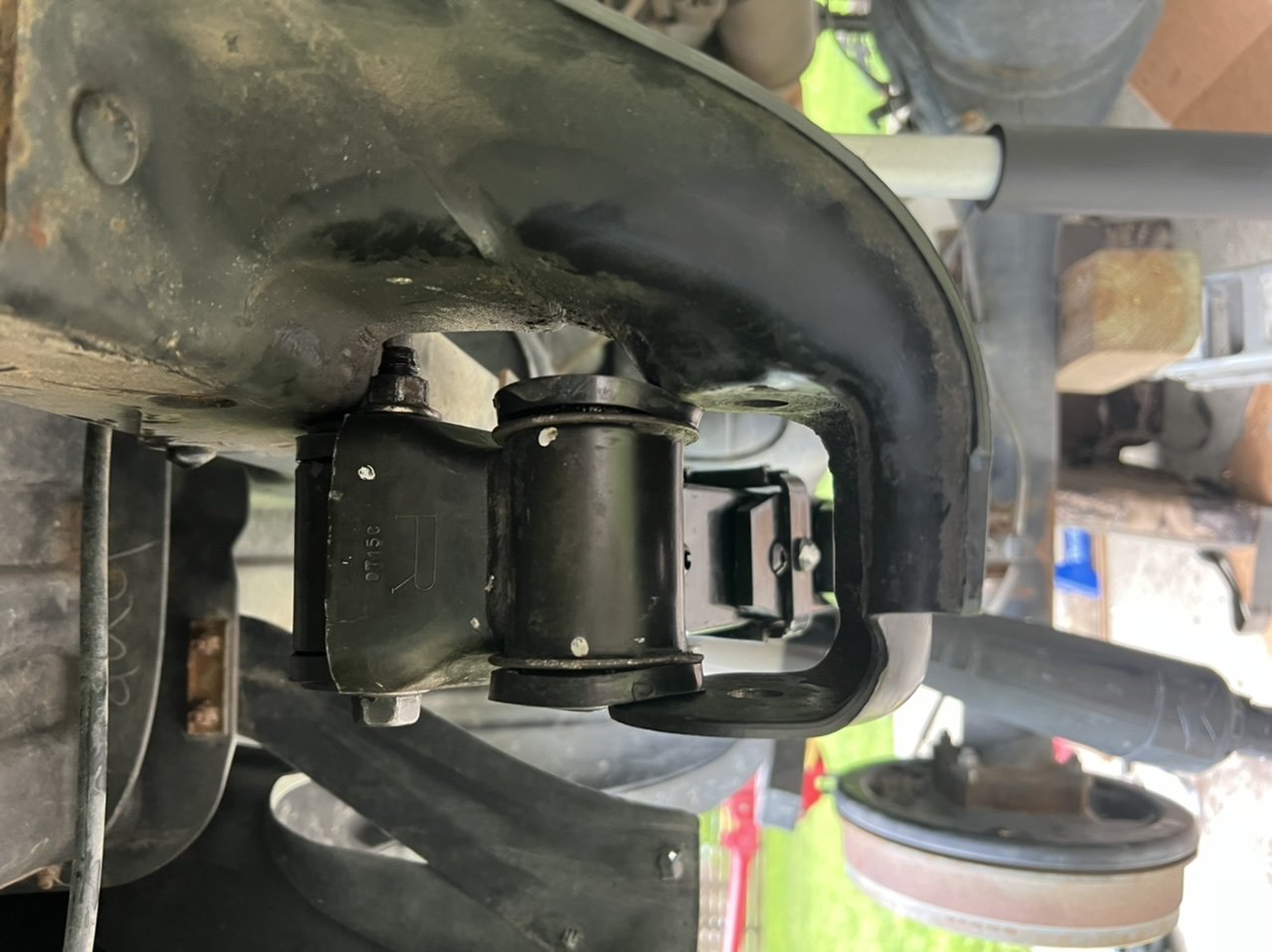

    Bumping an old thread for some input/help. Installing now and the new dobinsons bushings for the shackles are thicker than the OME ones I’m replacing. Having trouble getting the shackle back into position to slide the bolt through. Any help is appreciated!

    pry bar and grease, good luck

    New sleeve was in, I just needed to press the new bushing and sleeve into the shackle better. Used my bench vice to accomplish this and all set. These springs are awesome. Exactly what I needed with all my added weight.
