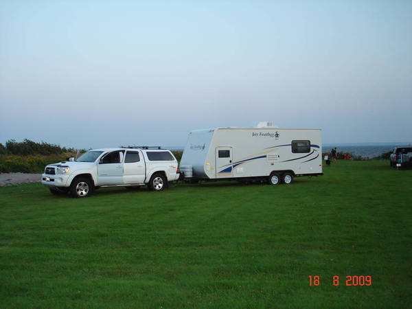

    I pull a 4500lb travel trailer with my 08 Tacoma sport (tow package 6500lbs) I also have the 6 speed manual. Once packed I am pulling about 5000lb and have little problems. I drove 4000km last year out east pulling it, no problems on highways keeping up 120km (75mph) but hills do kill me.
    I work the gears and can keep up. I live nowhere near the elevations your looking at. I think the weights your looking at are reasonable to pull with no problems.
    edit: I get about 13 mpg pulling the trailer.
