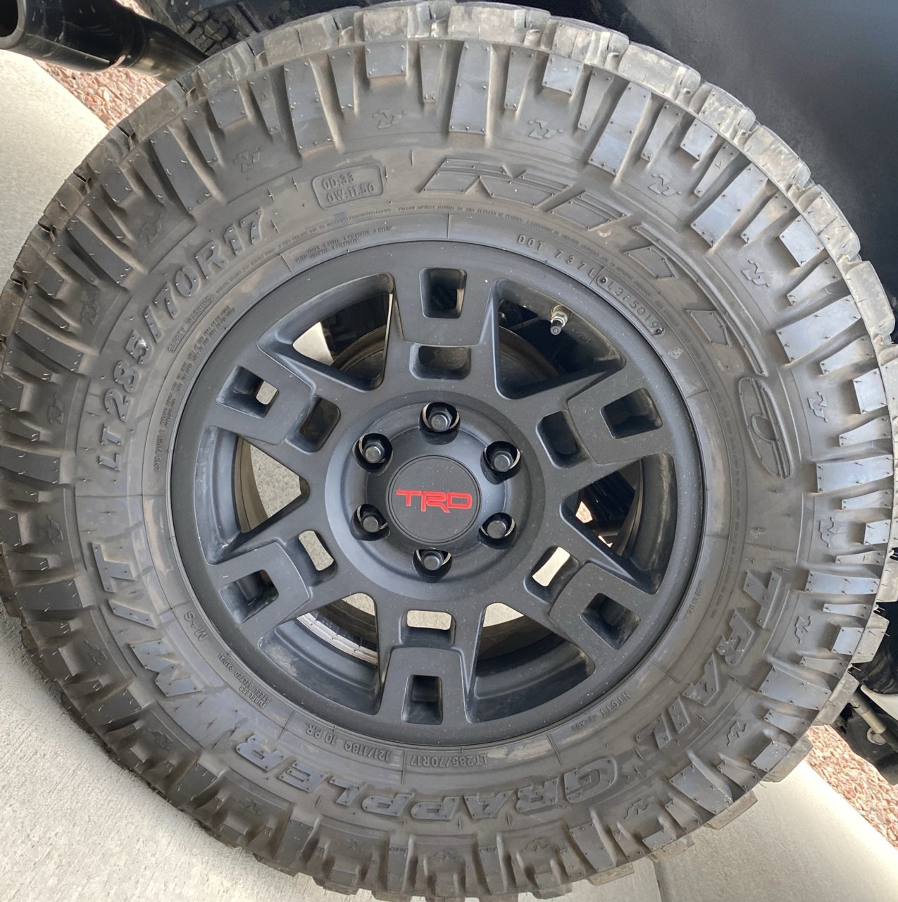

    I have this tire/wheel and have no rub and did not do a CMC. Toytec 2 inch lift and SPC adjustable UCA’s. People refer to the wheel as a 4-runner SEMA wheel. Unfortunately I do not know the off-set, they were on the truck when I bought it.
