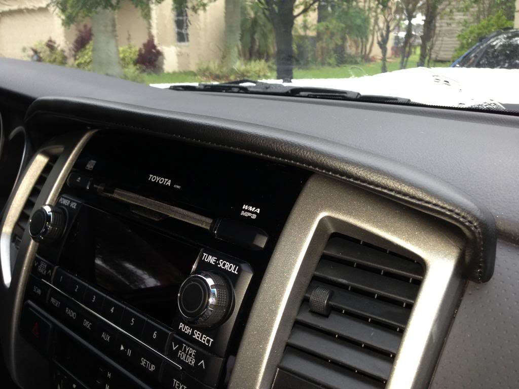

    Finally got around to doing it.
    Had an upholstery shop cover it with black vinyl, with stitching across the front. Screwed it into the dash with 2 black trim screws on top.
    Only wish now is I made it maybe an inch deeper to shroud the radio face just a tad more. Oh well. It does the job well enough, at a cost of about $10 in materials and $35 for the upholsterer.
    I used about 22g aluminum sheet, sandwiched top and bottom with plastic I cut from the lid of a plastic storage bin. The width was perfect with the 1" tabs on each end. The key is cutting everything to the right shape. Then had the upholsterer add padding and stitched vinyl.

    Thanks,
    I actually got it from a guy a few years ago in Huntsville. He was trying to mass produce them in different colors, and I was consulting him on marketing them, but he ended up passing away just before he was able to really tool up. He only made about a thousand, and he gave me a couple after touring his shop.

    Not hard to do.
    Just cut out a piece of cardboard about 5" x 20" and bend it to shape, including tabs on each end (about 1-1.5") for support, and scissor it up until you have a good template to cut the sheet aluminum with some sheers, and then youll be half way there.
    I could probably make one again in an hour, not including the upholstery, but you know how that goes. Every time you do something it gets a lot easier, to a point.

    Close up
    It sticks out about 2.5-3 inches
