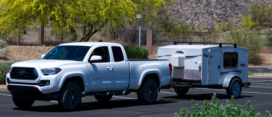

    I tow a 3,500 travel trailer, in the mountains,often with my Tacoma. I have towed from Phoenix to Seattle, returning cia Idaho and Montana. The truck is capable of towing 3,000# through the mountains, but needs trailer brakes IMHO

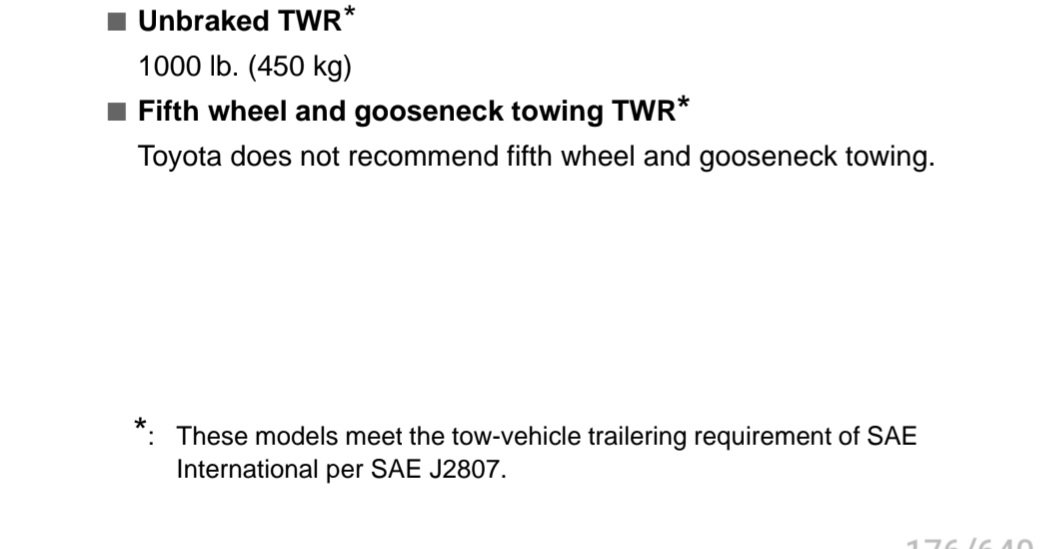

    According to the owners manual (page 171), the maximum unbraked trailer weight is 1000lbs. So Toyota has determined that the brakes on the truck can safely handle 1000lbs but above that, the trailer needs to be able to brake itself to be safe.
    Edited screen shot to included * explanation.
