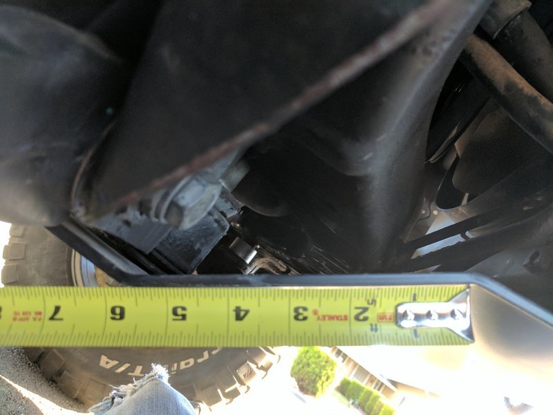

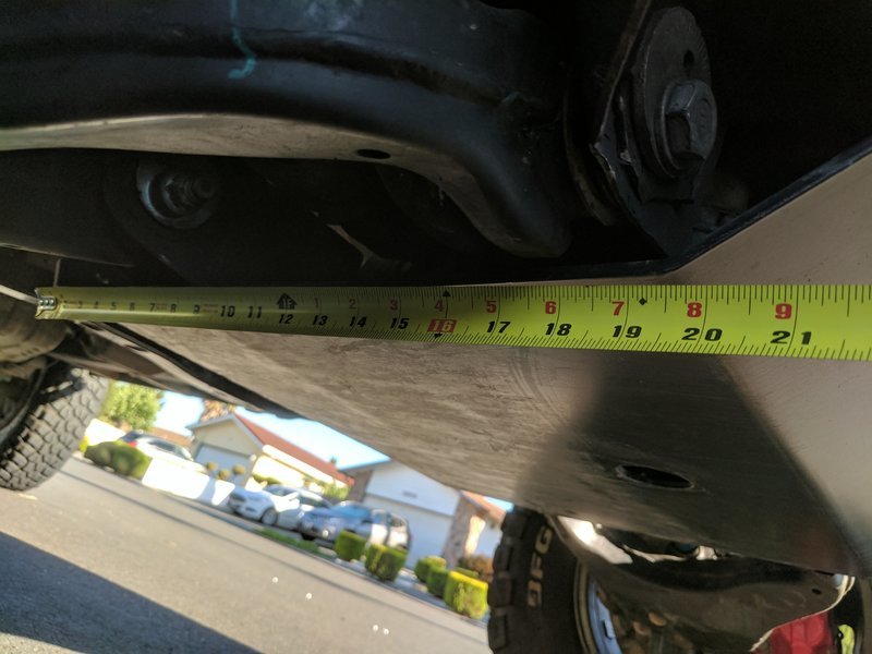

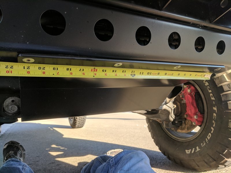

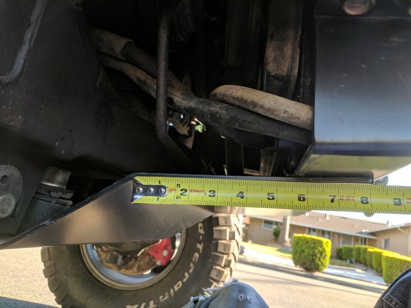

    Hey man, do you think you could grab some measurements for your all-pro skids. I just picked up the apex bumper and want to make my own skids.

    #202
    SeekingZero

    Here you go. If you don't have the lower radiator guard piece, attaching the skids may be difficult.
