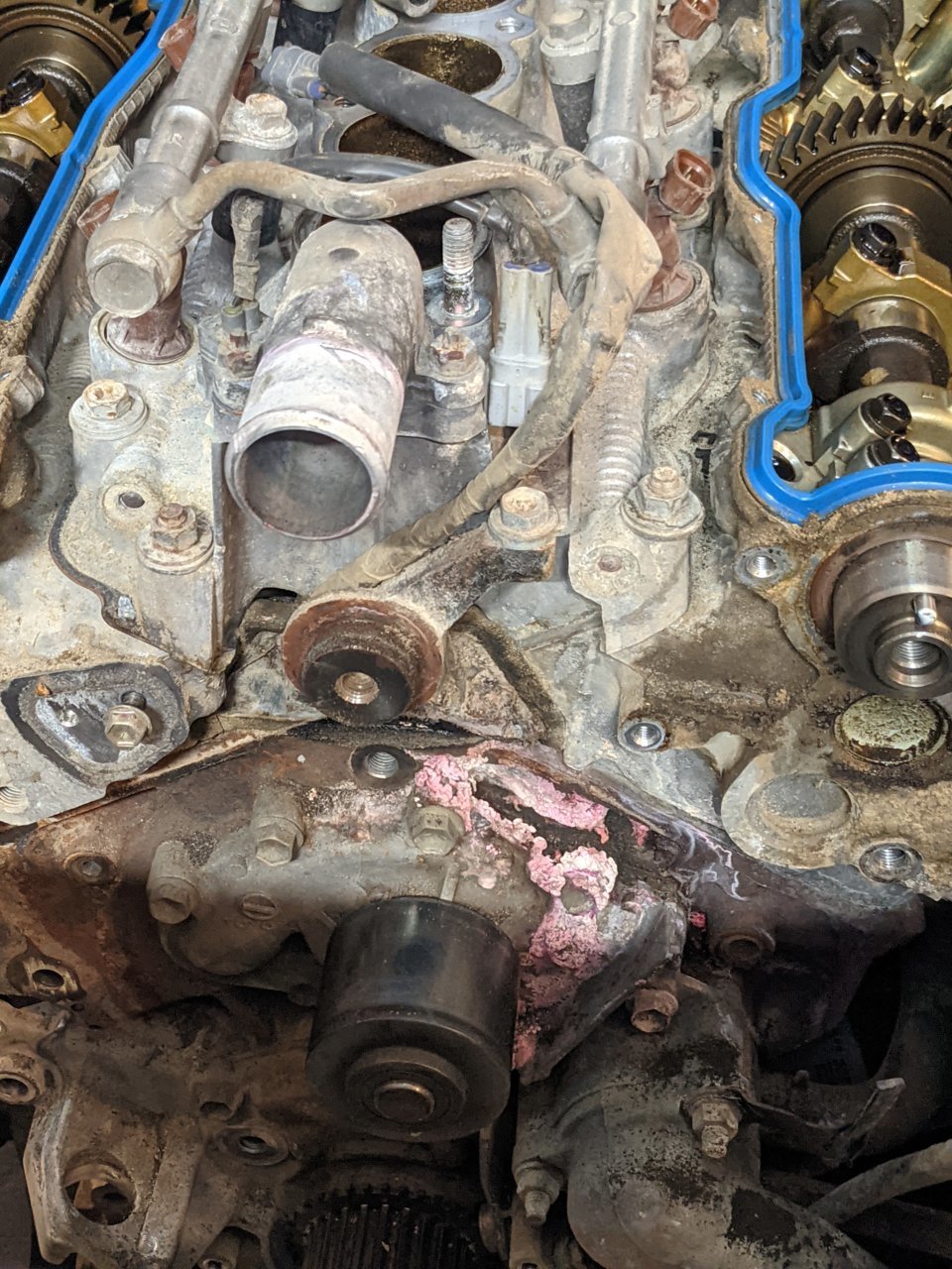

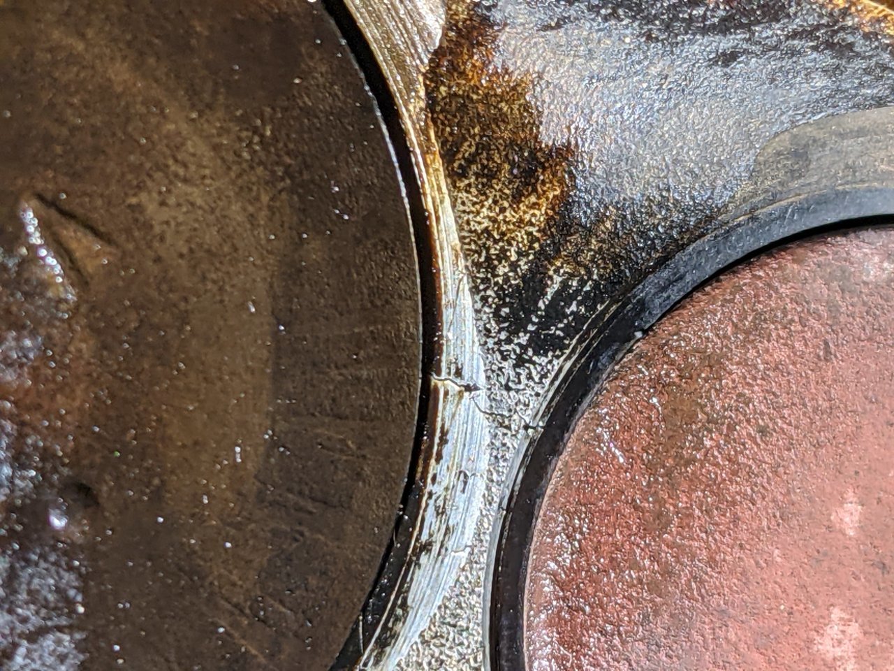

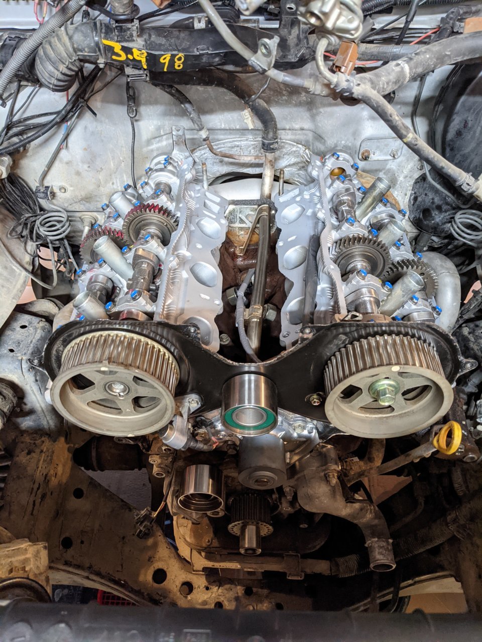

    So while I'm working on selling the Drifter, I might as well give a post-Covid update.
    In the two last years it's been engine and supercharger rebuild and new tires. The truck started exhibiting symptoms of a cracked head. So I ordered some refurbed heads from Jegs and got to work.
    While I was in there, I planned for a whole refresh. New water pump, idler pulley, timing belt, battery, and thermostat. I even replaced the fan clutch oil with a different weight so it would come on sooner and help with those overheating problems that likely got me here in the first place. Here you can definitely see some antifreeze remnants.
    The passenger head was the culprit and from what I know is a fairly common weak point on the 3rd cylinder.
    Dropped that in the box to get my core charges back and got working on all the new shiny bits. During this time, I sent the S/C off to San Diego to be inspected and rebuilt. Turns out I beat the shit out of it and needed all new impellers. Nothing like unexpected expenses during a rebuild...
    And then reassembly once the S/C came back. I took the time while I was in here to also clean up my wiring, remove the excess rat's nests that build up with increment quick mods, and replace my hood light with a better LED strip. I also relocated my washer fluid with a different tank out of a chevy vehicle, if I remember right. It took some modification and wasn't quite bolt on, but it works well in that location. I was forced to do this since my tire took out my original in a wash in Death Valley...
    All put together and then re-shoed with some normal 33's, instead of the skinnies that I couldn't get to align (not enough camber on my LCA), just in time for @tacomgee 's bridal shower. :jerkoff:
