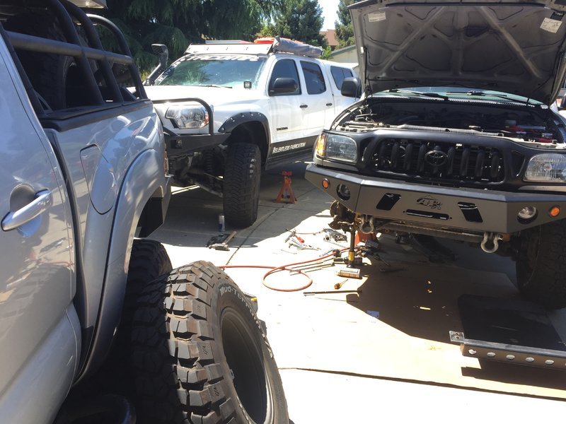

    This mod session has got to be the most frustration and the longest I've had yet. To recap, Saturday I went over to @MJonAgs32 to get started on new LCA's (because my bushings are fused to the cam sleeves and its cheaper and easier to just buy new LCA's than bushings), Tundra brake upgrade, steel braided lines to go with the brakes, and what I had hoped I would have time for...rear axle relocation.
    Cart of mods!
    This was about the point the frustration began...
    The brake lines were frozen solid and took a couple days of soaking in PB blaster and a flare wrench to get them undone. Take your time with this step, otherwise you'll be off to the auto parts store to buy a new hard line.
    New LCA's and Moog camber bolt kit.
    One on! You might notice that the incredibly long bolt on the left of the image sticks out quite a bit. In fact, that is where the steering rack goes and I had to end up flipping the bolt so it could clear. Come on Moog, its not like this is a universal kit...
    By the second LCA, I had had enough and just went nuts with the grinder and BFH...
    But the end result was worth it!
    Sunday, I'll swing back by to bleed the brakes and be out of MJ's driveway! Axle relocation will have to wait.
