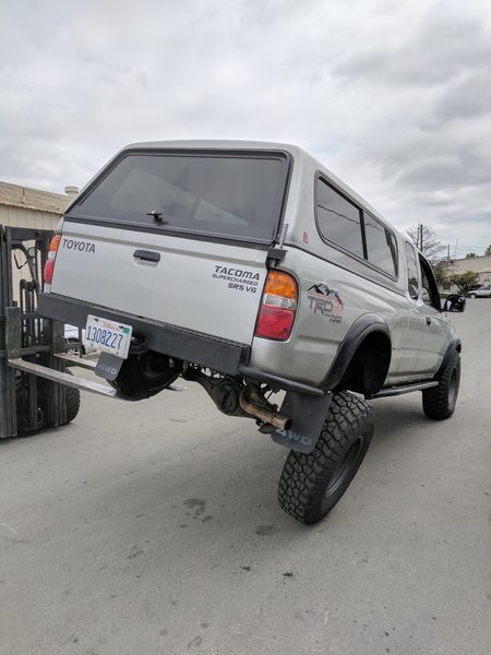

    SeekingZero
    SeekingZero [OP] Well-Known Member
    Sep 22, 2013
    #113063
    577
    Ben
    Sierra Mountains, CA
    01 Xtracab 4x4 SR5 TRD Supercharged
    Out with the old...

  14. May 11, 2017 at 9:06 AM
    #194
    Dan8906
    Dan8906 Well-Known Member
    Jul 26, 2016
    #192977
    5,138
    Daniel
    Concord, California
    2004 Tacoma ext cab TRD 4x4
    CBI sliders, ADS extend travel with compression adjuster coil overs, 9” Bilstein 5125 rear shocks, Icon Tubular UCA, Alcan custom leafs, All Pro Apex bumper and skids, NWTI rear diy bumper, 295/70/17 Cooper St Maxxs and nitro 4.88s.
    holy crap! did your truck come from out of state?

    SeekingZero
    Sep 22, 2013
    #113063
    577
    Ben
    Yep, Midwest truck!

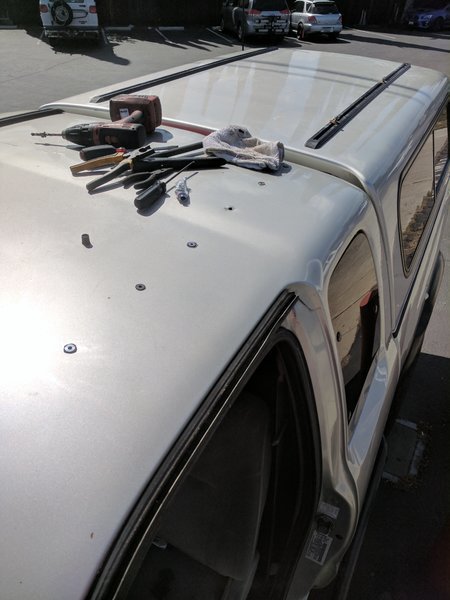

    SeekingZero
    Sep 22, 2013
    #113063
    577
    Ben

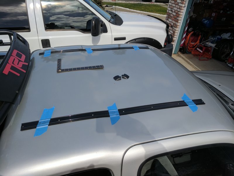

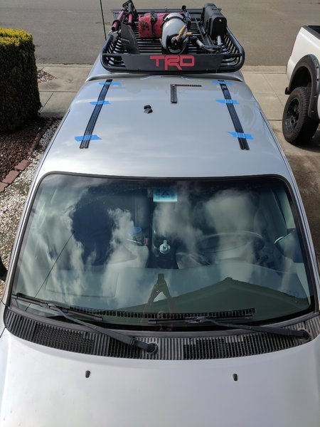

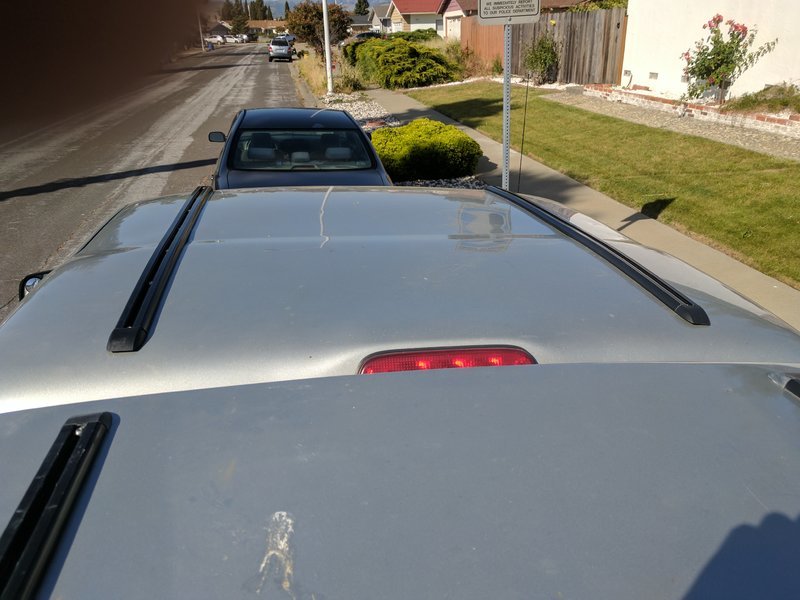

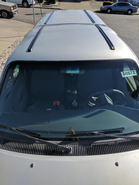

    I got started adding the Yakima tracks to my cab roof a couple months ago and just got finished with. Wasn't a difficult job, things just got in the way.
    IMG_20170325_110855.jpg IMG_20170325_110842.jpg IMG_20170511_154241.jpg IMG_20170512_165013.jpg IMG_20170512_165057.jpg
    Now I'm all set to install the new rack. Hopefully I'll have it finished by June!

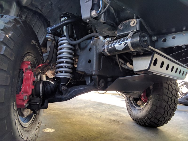

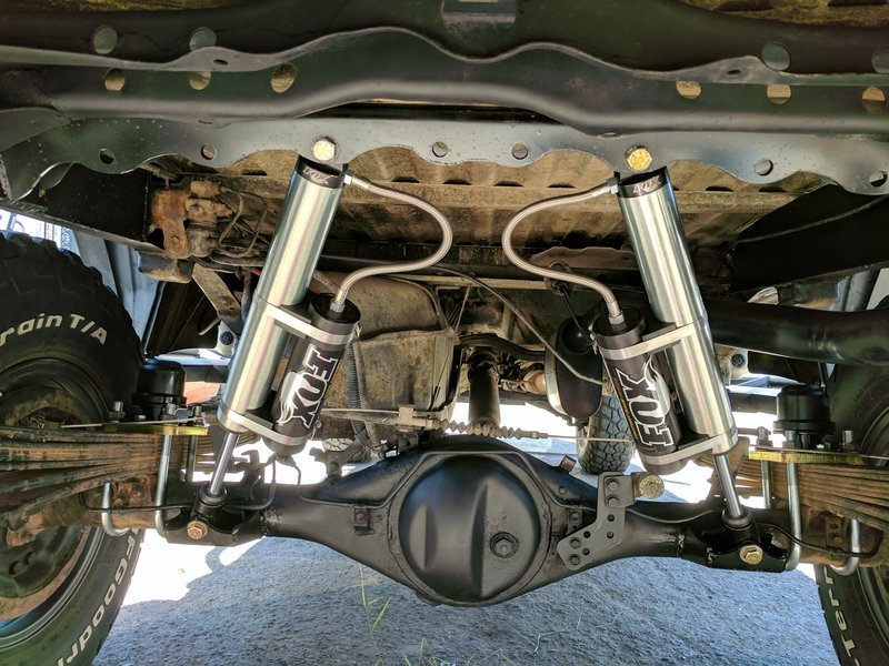

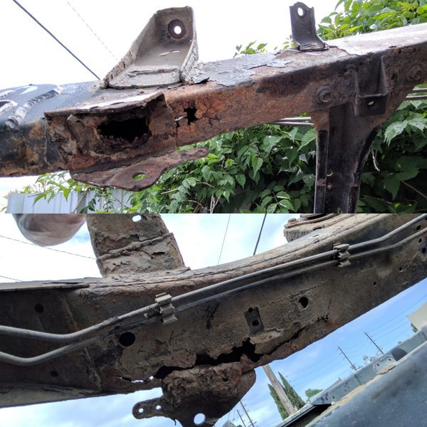

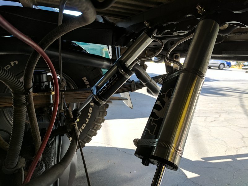

    #113063
    577
    Ben

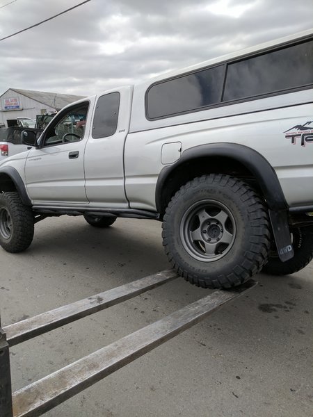

    Finally, after a long long wait time (for me anyway), I finished up the biggest and best set of mods yet! Since the frame was fucked, and I probably made it worse on the Death Valley trip, that was swapped out.
    Newish California frame now has a full Fox suspension, Icon UCA's, manual locking hubs, diff drop, extended CV's, front wheel bearings, boxed rear frame, U-bolt flip kit with Wheeler's bump stops, and BAMF shock relocation kit. :evil:
    As soon as the rest of my PrinSu comes, the truck will be ready to hit the trails again!:mudding:

  20. Jun 12, 2017 at 8:10 AM
    #200
    04yota
    04yota Well-Known Member
    Mar 12, 2014
    #125177
    1,220
    Angelo
    Central New Jersey
    04 ext cab supercharged 5speed
    Holy cow what a beautiful truck!
    Did you have to trim the fenders at all?
