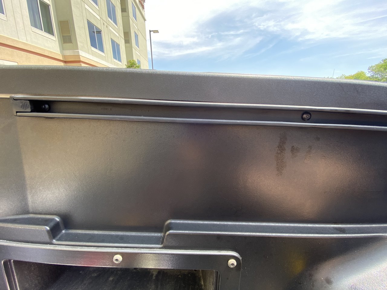

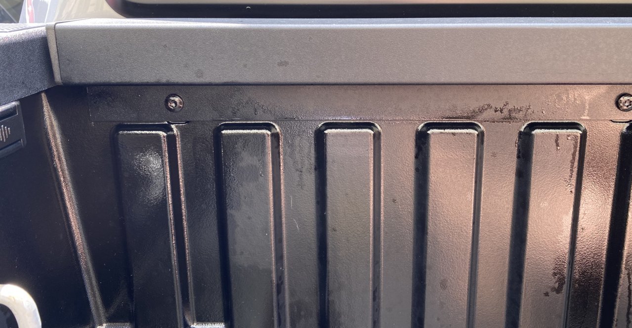

    Good Afternoon everyone,
    So I’m trying to install my tonneau cover that I just bought and I have to remove the existing cargo/mounting rail and the top edge cover against the cab. However, the screws have seized and was wondering if anyone has tips on removing them. I’ve tried spraying them with PB Blaster, but seeing how the screws are in horizontally, it hasn’t done much of anything. I’ve attached some pictures for reference.
    732DE519-E51D-46AC-AABA-C440B2E77A45.jpg 299E2770-93E0-4C31-A14E-0A1A8370FEF6.jpg

    More than likely they are not seized but are held by loctite. I know that heat will help but obviously that is a tough spot to apply heat without damaging something.
