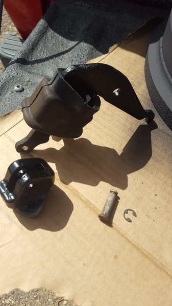

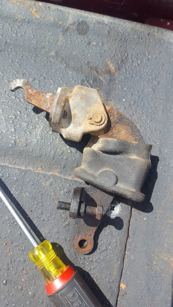

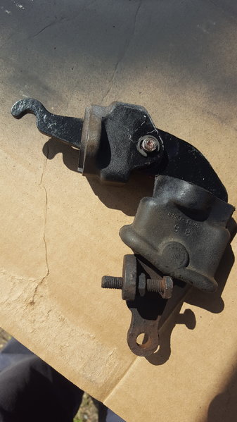

    I figured mine were too far gone but i tried to restore them anyway.
    Total cost: $0.60 (2x c-clip)
    I broke off the old horseshoe clip and hammered away at the pin with a punch. I was finally able to work it loose after lots of pb blaster and precision pounding.
    I then cleaned up all the components, sanded off the majority of rust, primed and painted, reassembled with some grease, and installed the new c-clip.
    More detailed writeup: https://www.tacomaworld.com/threads/how-to-clean-bell-cranks-ebrake-stick-fix.140573/
