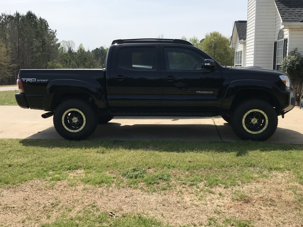

    Baja has the same offset perch, but I still ended up with a slight lean.

    I’m going on a 1000 mile weekend road trip at the end of next week. I suspect it will fully settle (if it hasn’t already) by the time I get back. I’ll update with measurements when I get back.

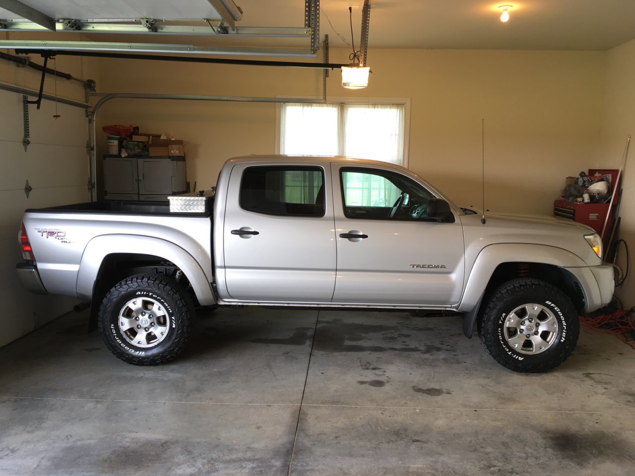

    Good looking truck! Basically I have a twin to your truck but there are a new set of FN FX Pro wheels sitting next to it to install. I measured 19.75 LF and 20.00 RF hub to fender (21.75 LR and 22.00 RR.) Haven't installed my kit yet and still trying to decide on which AAL, OL in or out, etc largely due to the amount of lift it seems like some are getting. Will be watching for your settled measurements.

    I installed the TRD Baja kit (basically the same as the Pro but with 650lbs front springs vs 600lbs, and slightly different shock valving). I have a Pelfrybuilt steel IFS and steel mid plates (about 100lbs of steel). Tool box in bed with misc stuff, not too much weight). I have TSB rear springs (about 35k miles on them) + AALs and left the overload in. Put on some 265/75/16 KO2's. Truck rides great, no complaints about harsh rear. I've loaded it up with firewood and had just a tad bit of sag in the back.
    Edit: In case it matters, 2010 DCSB Off Road (otherwise stock)
    My measurements are:
    DF: 22
    PF: 22.5
    DR: 23.5
    PR: 23.75
    I have the drivers front strut set on the higher notch, but still ended up with .5" taco lean. It's not really that noticeable not sure if I'll add a spacer in the future or not.
