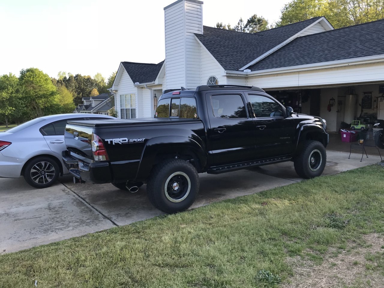

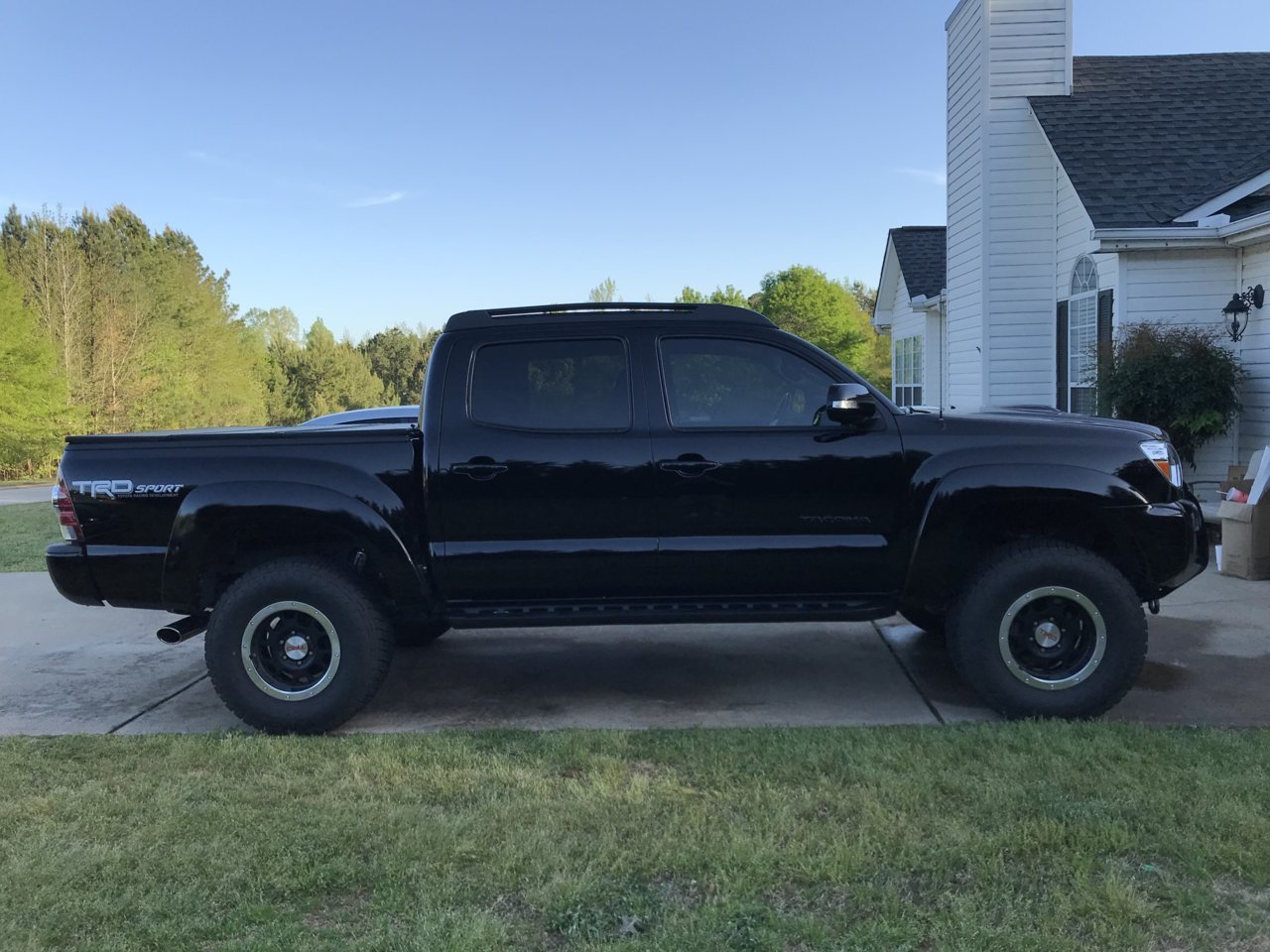

    500 miles on my TRD Pro suspension and still sitting at 22.75” front left and right and 23.5” rear left and right
    I’m gonna swing by Summit Racing today to get new leaf spring pins and throw the overloads back in after my trip this weekend to get some of the rake back in the rear. I’m damn impressed with the ride quality so far and loving the height I’ve gained. From everything I’ve read I’ve gained between 2.25” and 2.5” up front over a stock TRD Sport

    Update: it’s been just shy of 3 weeks since my install and I’ve put roughly 1800 miles on the system. About 1000 of that was hauling a 400 pound bike in the bed. I’ve hit hard dips and bumps to try to settle the suspension but it’s staying at 23” front left and right and 23.5” rear left and right. The AAL and 5160’s did amazing with the added weight in the bed. Honestly didn’t even feel it was back there.
    So is it safe to say after that much driving the suspension has settled? I’ve got the new center pins to install my overloads...just don’t wanna do that and suddenly my front drops 1/2” after 2500 miles or something.

    No spacers at all. I’ve decided to give it until my next oil change to do the overloads. I do not anticipate the front to drop anymore but just to be safe I’ll give it 3k more miles.
    The ride is much better than the stock sport. The truck reacts to large bumps and dips very well, also sweeping turns feel more planted. I especially noticed it with my 400 pound bike in the bed, where the stock Sport suspension would bottom out the Pro with the AAL doesn’t. Honestly felt like nothing was back there.

    I just realized something. The Pro suspension is rated at 1.75” on a 4x4. Since my truck is a prerunner and missing all that extra 4x4 weight up front is probably why I got the extra 1/2”ish of lift.

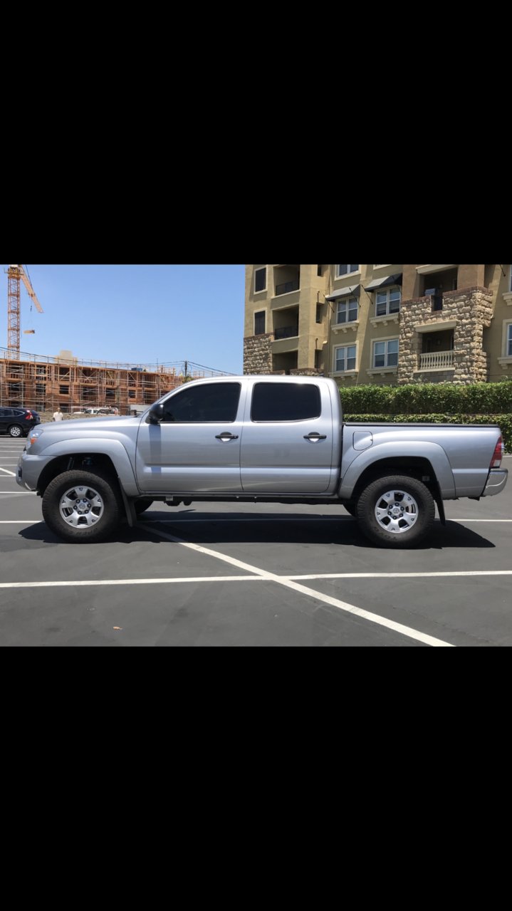

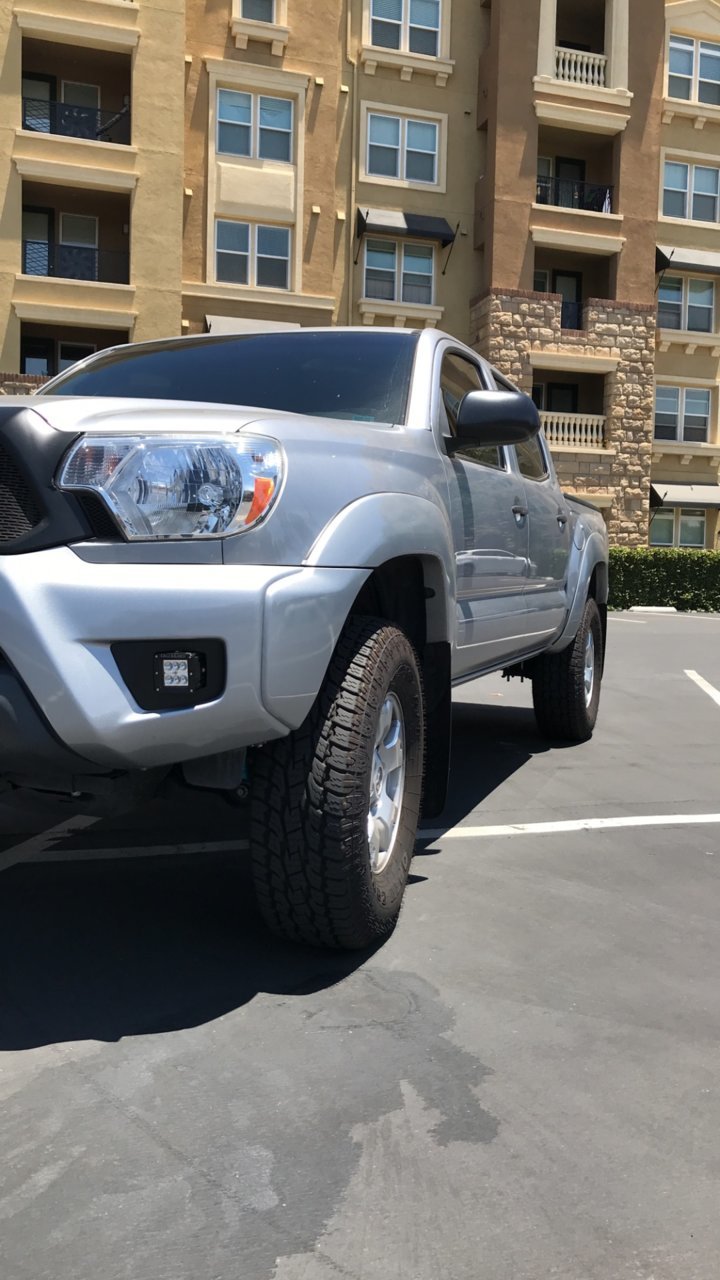

    I just purchased Bilstein 5100 & Icon AAL for the rear on my ‘15 Tacoma 4x4. I currently have Kings coils in the front at the preload that was set. Can I crank up the coil overs an extra inch with stock UCAs? Any issues if so? Thank you!

    An inch or 2.. i was told it was gonna stiff-in the ride if I didn’t replace the stock UCA.

    An inch or 2 over stock? The Baja/Pro are 1.75” over stock, you’d be fine. If talking about and inch or 2 over current lift, that is a whole different story and will likely make it stiff and require new UCAs depending on base lift.

    I kept the front shock height as is. Adding the Bilstein 5100 and Icon AAL.
    Thanks for clarifying.
