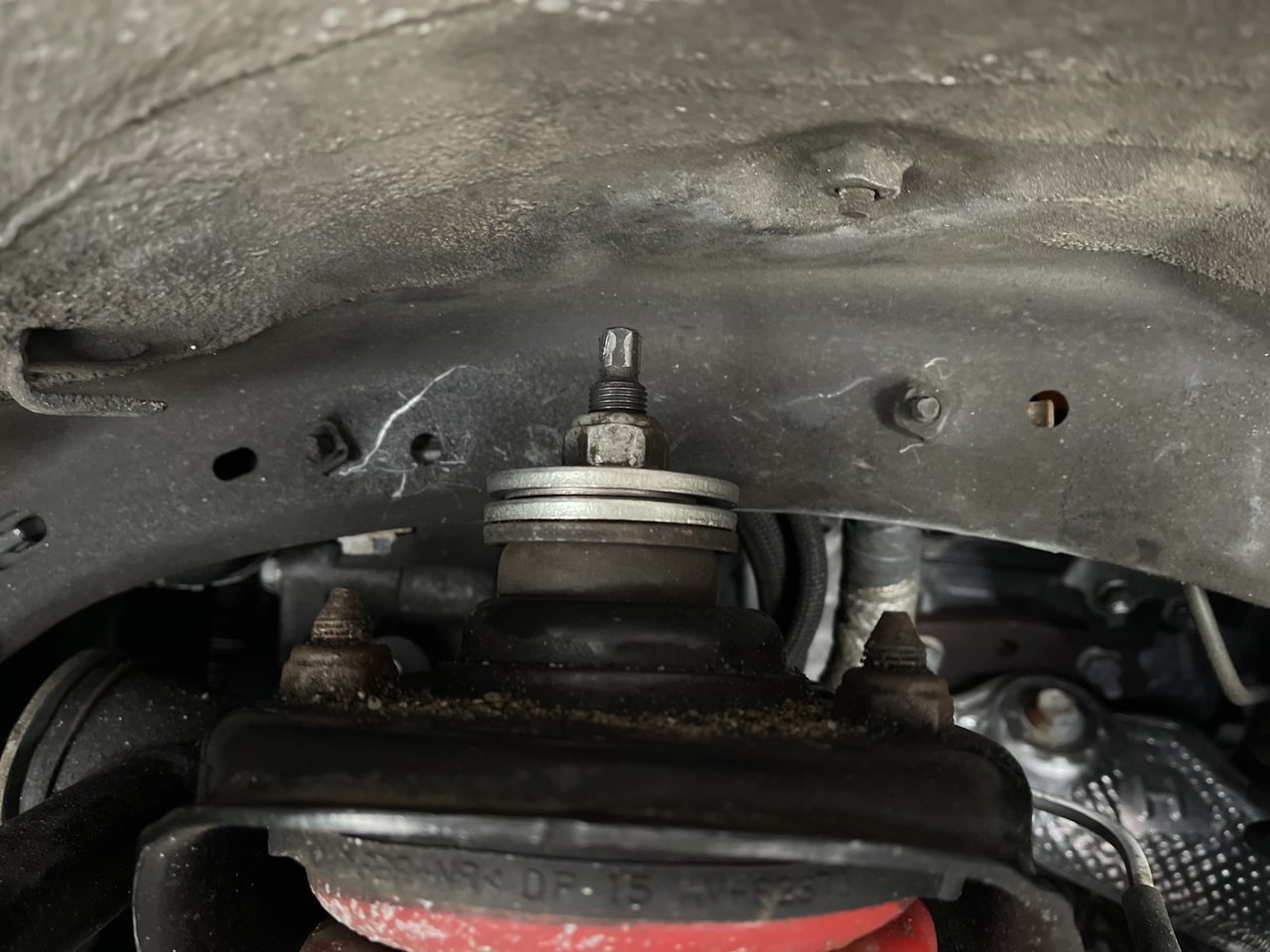

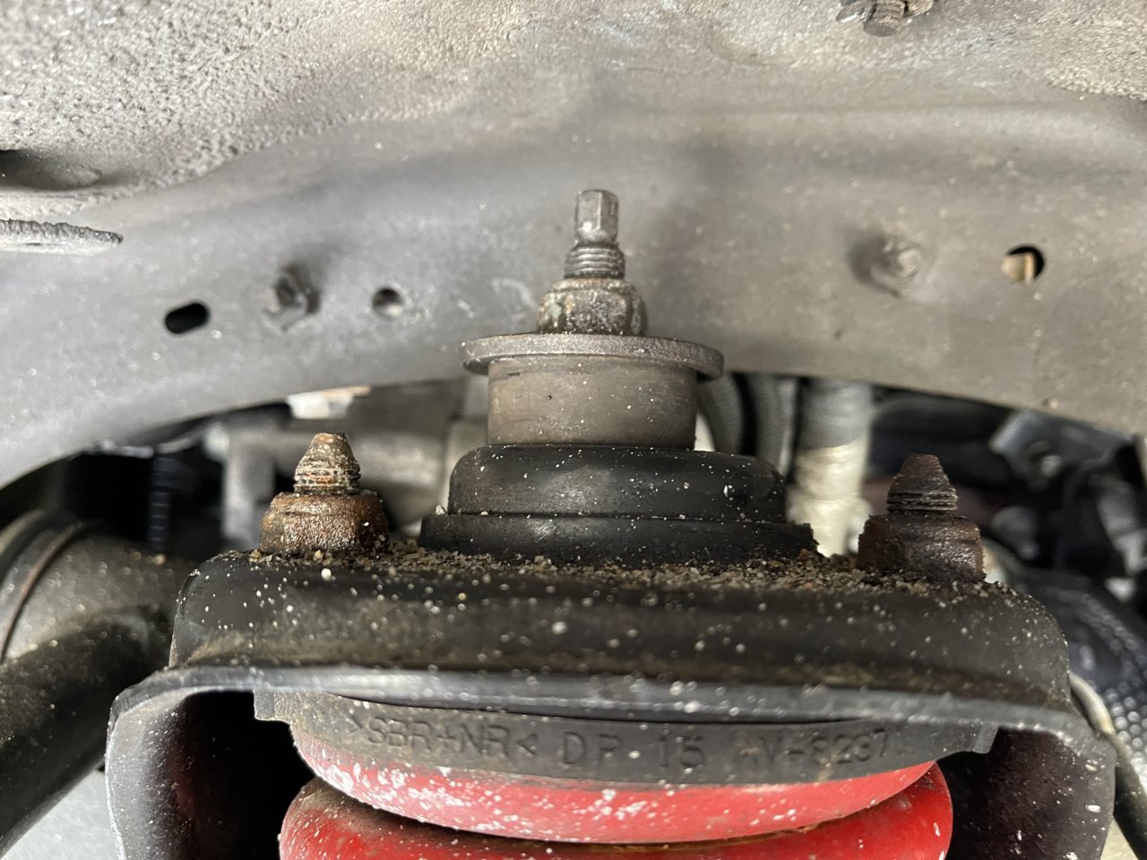

    So I guess the place that had install them and did an alignment back in 2018 did not do it correctly. Leaving the upper cushion lose. Not noticing or thinking to add spacers. First picture is loss. Then after I added spacers. 22970865-625C-4367-95AA-46073C6EB8ED.jpg03414C4C-730F-4B45-BCF3-ED871CD9F58C.jpg
