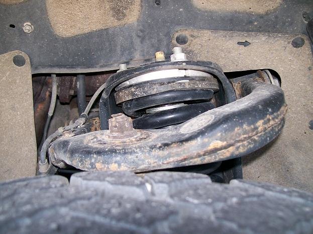

    82839d1278373424-1999-4runner-ome-881-89_7a0c7c8a42752dcec10f0db134f11b4b45a263ba.jpg
    Is this spring or top plate?

    I'm not sure if it would fit in the strut or not. The spacer would go at the bottom, around the shock body, between the spring seat and the spring.
    However. The Baja kit does use shorter front bump stops for extended up travel. One workaround may be to just use the full size OEM bumpstops from your offroad to compensate, rather than switching to the short bump stops.

    That is a top plate.

    Hmm. I thought headstrong did, but it looks like they actually bundle a 1/4" top plate spacer with the 6112s. OME makes a spring spacer (headstrong sells) but I do not know if it would be compatible. I'd suggest running the top plates you have and leaving in the larger non-Baja OEM bump stops.

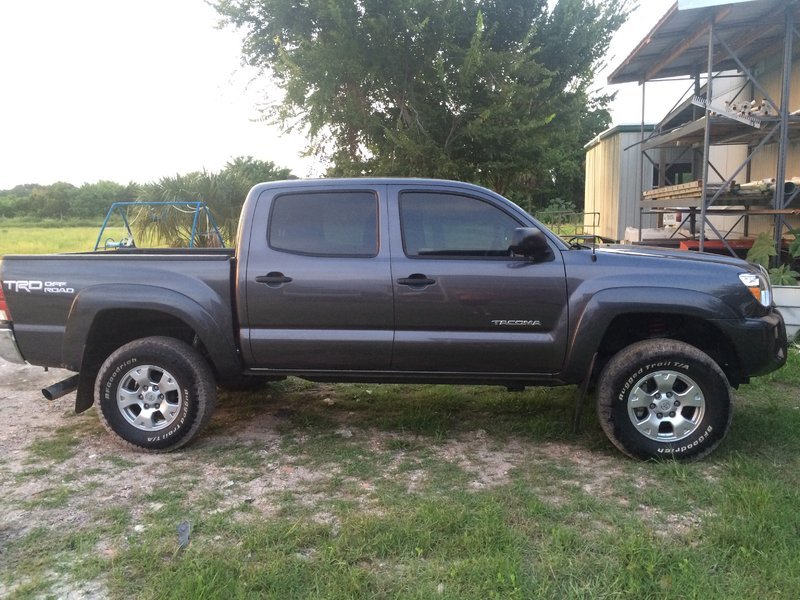

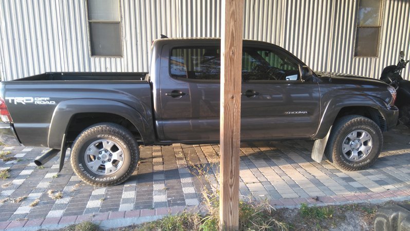

    So I ended up taking the overloads off and not using the spacers for now. I thought it would defeat the point of having extra travel on the shocks if I restrict them with the bump stops (actually I don't know if that statement is true..). Anyways I only have a couple of shitty before and after pics but I'll post them anyways. I have to say the operation was easy, I got it done in a couple of evenings. First impression is good, I only drove it 20 miles or so to get an alignment and back so can't say much. Feels a bit stiff and fun and happy with the small lift. Seems like there's a lot of clearance under there, more than a lot of other lifted trucks I see around here. I had major squeaking coming from the driver side leaves even though I kind of blew air on them and sprayed that liquid film while I had them spread out. I pressure washed them good and the squeaking is gone.. I guess tires will be next once these wear out. Thanks for all the help and looking forward to driving a bit more

    Running top plate spacers does not reduce travel. Running coil spacers does reduce travel. The top plate spacers can cause your bump stops to not make contact before bottoming out the shock, however I think using the higher stock bump stops instead of the low profile Baja stops with the spacers would pair nicely, and not cause you any lost travel. Would have to measure to be certain. If you wanted to go that route in the future.
    Likely looks like a lot more clearance that other lifted trucks because you haven't tried to stuff a tire too large for your lift in there. :) 265/75R16s will fit nicely.
