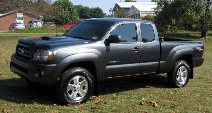

    I had a local guy do my tint was really nice and cheap!!! i think it is a headache to do it your self and look nice..... but i could be wrong

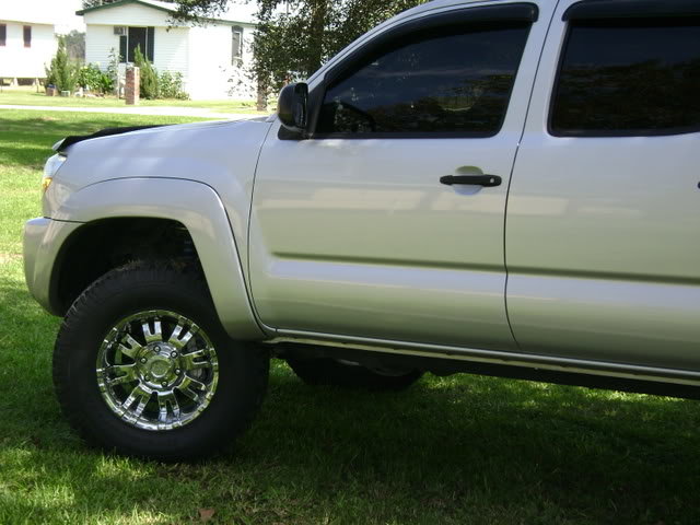

    When I was younger we would get tint from autozone and cut it to fit. Cheap but you need to take your time. To match front to back go with 20% on the front. That is just for reference. 35% would be light but it is your call, the percent signifies how much sunlight is allowed to pass through and into your cab. Our trucks allow a lot of light through the windshields, I think 20% in front and maybe 35% on the rest. Don't forget a Strip on your windshield, I always use 5% for the strip.

    To do it youself you need to wet the shit out of the outside of your window and put the tint on there to cut it to fit. Remember put it on the Passenger side and cut for the drivers window and vice versa. Personaly I would pay someone to do the truck it will take hours to get a good job. JMHO
    This is 5% all the way around.

    best pic i have sorry it was my old truck.... it was 35%!
