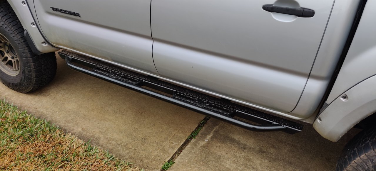

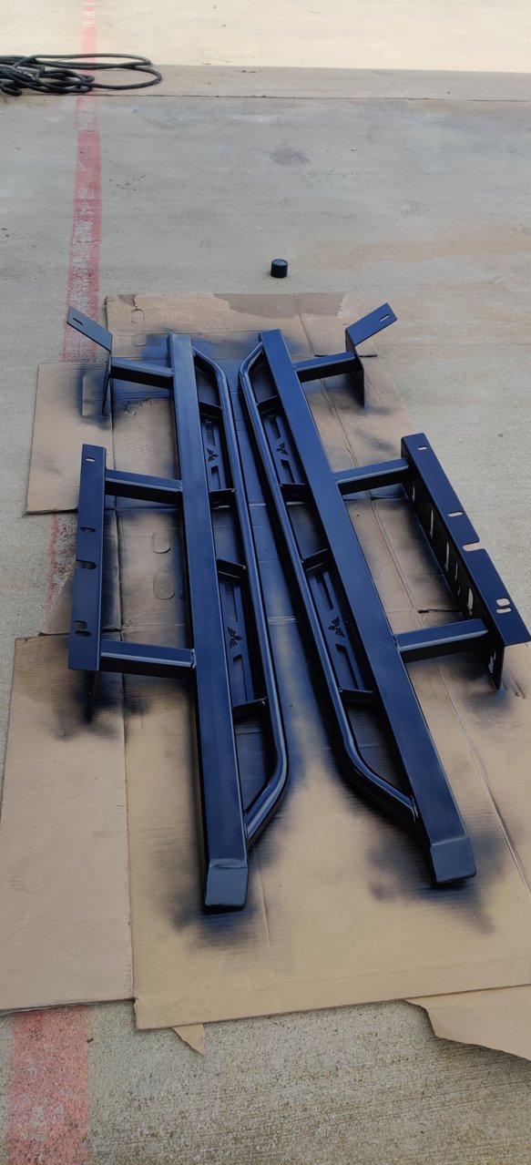

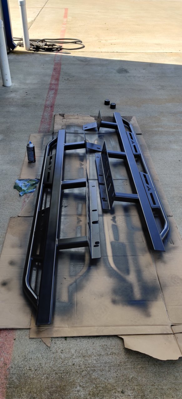

    I will use self etching for painting chrome bumpers to match or any kind of bare metal. Anything that will be black or high use (sliders, bumpers) I will utilize epoxy as it is a much stronger finish and provides much better corrosion, chemical and rust resistance.
    Epoxy will not require any primer and I can take a screwdriver to it and it won't scratch.
    Primer filler is mainly for plastic parts to fill in gaps and scratches.
    With that being said, VHT rollbar and cage black epoxy. Works wonders everytime.
