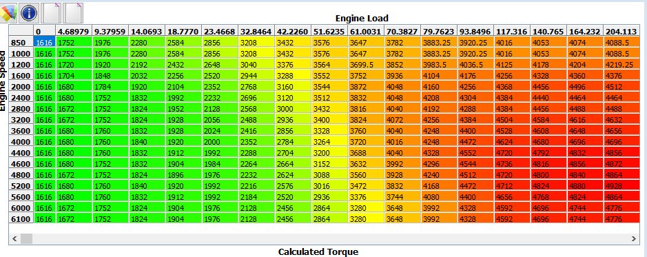

    Pedal lag/dead spot? At lower shift points 3,2,1 then step on the gas and get lag before it catches the gear? I made changes on the Optimal Engine Torque Map (nm). I increased the first column by 1% and put same numbers in the 850-1000. This has helped me get rid of that annoyance.

    OLD school trial and error! IMO the aggressive airload/throttle tables was making the ECU react quicker then the transmission brain could comprehend at slow speed and lower shift schedule. I studied the stock maps and noticed between 850 and 1000 the numbers were all jumbled up. I first increased the optimal torque map by 1% across the board but settled for 1% in the first column and matched the higher numbers in 850 and 1000 and the lag went away. I also went to a custom single transmission map across the board and I feel it has helped transmission and ECU communication. Also made minor changes to the 2.0 base intake valve angle map that has help me in other areas. I'm NO expert I just read, study, and do test runs to see what works. I attached my Airload-Timing stuff for review. Several folks for have helped me just figured time to give back!

    Yes...If the numbers don't look the same just go 1% in the first column then in the first 2 rows make the numbers match and put the high of the two in there all the way across.
