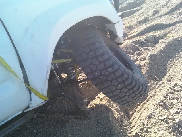

    Guarantee the problem was the single-shear shock mounts. The mounting bolt probably snapped in 3 pieces when the truck landed.
    There should be solid supports for the mounting bolt to go through on BOTH sides of each shock, not just on the inside. That's a rookie mistake and not one I would have expected from that fabrication shop.
